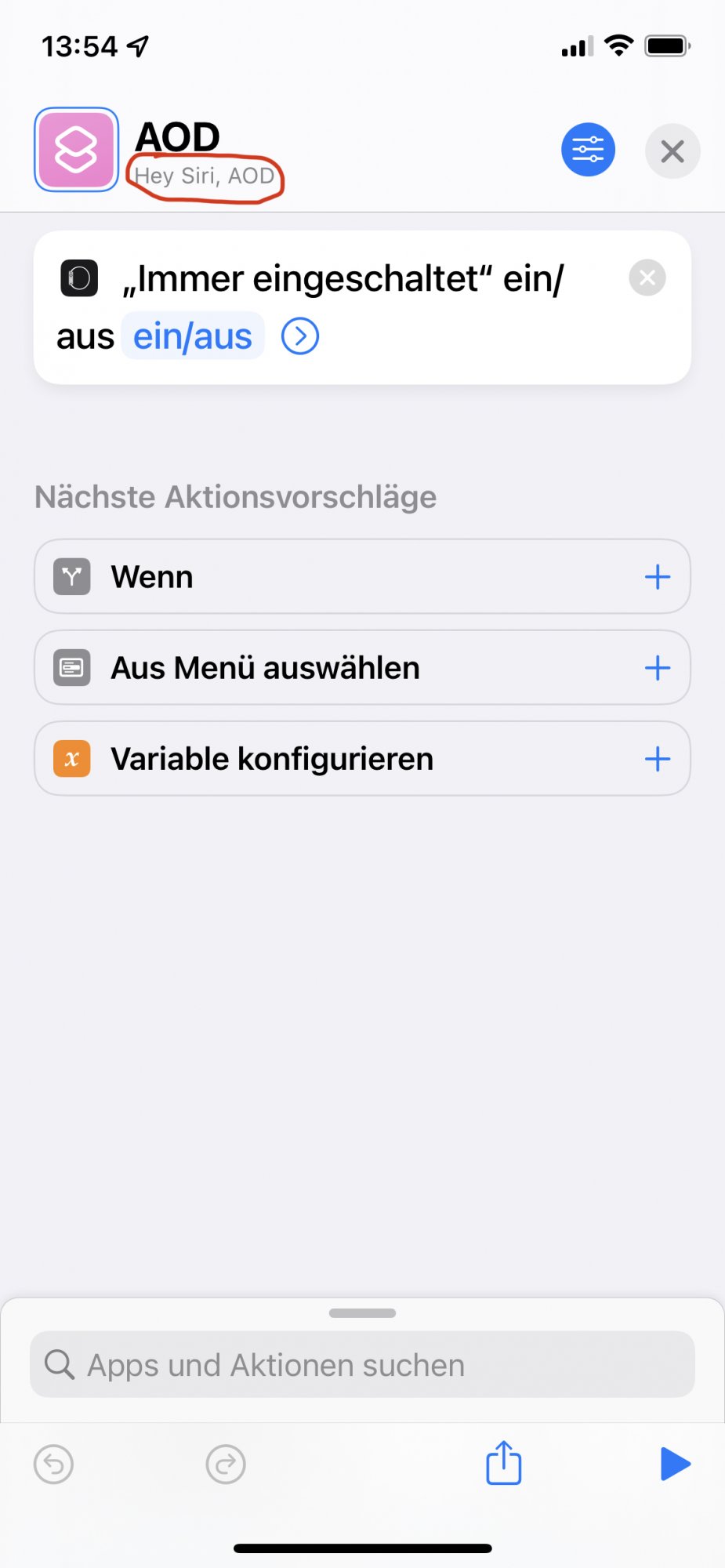

I couldn’t find a way to use Siri to turn AOD on and off. What is the command for that?
Just create the shortcut and you can activate it by saying ‚Hey Siri, <shortcut name>‘
Nice. Got it to work with Shortcuts. Now I can save battery life when I’m traveling or doing photography with the Watch, and keep it on for other cases with a simple command. Kind of perfect.
