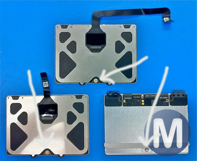

I think the OP may be talking about a click before the actual click, which happened to my MBP. Apparently it was the layers of the trackpad that had separated. In the end, I just tightened the screw at the center of the trackpad from the inside of the MBP. On my 2008 MBP, it's as simple as pulling out the battery.

I am also having a problem with my MacBook trackpad. It doesn't click at all anymore. I've taken it to the Genius Bar a couple of times and they have adjusted that same screw I imagine and made it work, but it has happened again (3rd time in under 2 years ... very annoying). I'd rather just service it myself, if it's not too involved.
Do you know where I can find more instructions on this procedure and whether there is a way for users to do it themselves on MacBooks without removable batteries?
