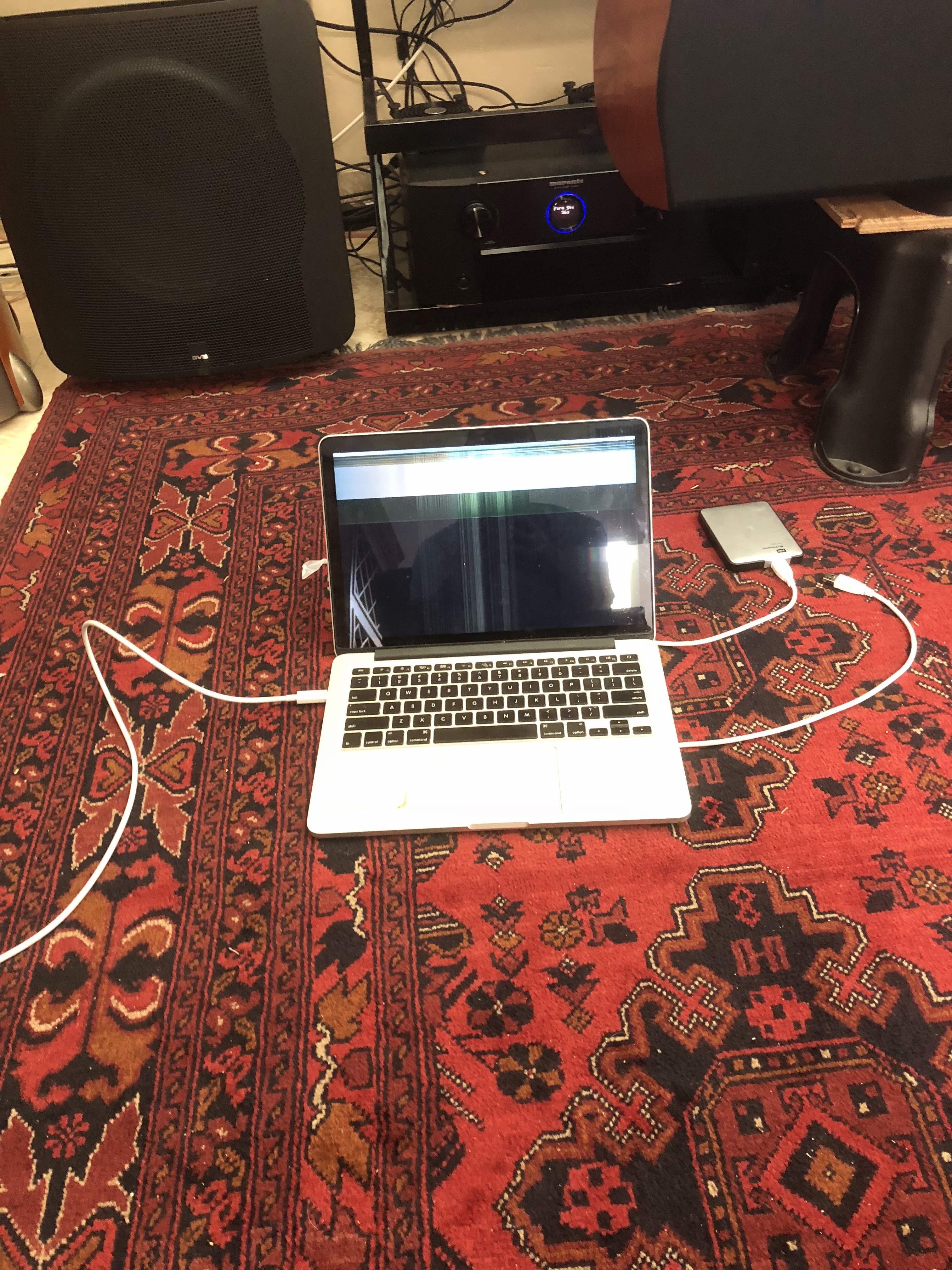

[doublepost=1527271042][/doublepost]I'm not sure if this is helpful; but here's a pic of what the screen is doing:
Side Note: that white bar seems to run down the screen (top to bottom) & then starts over. During this process I am able to see the time, battery strength indicator & keyboard icon in the top right corner of the screen (however, all other processes that are usually up there (upper right corner) are not visible . . .
[doublepost=1527272152][/doublepost]Greetings Good People of Planet MacRumors . . .
I am so excited that this Target Disk option is working . .. I'm actually txfring date at this very moment . . . I can't thank you enough . . . (((At the risk of TMI, I had a significant amount of information that I needed for an upcoming court case, against the sellers fo the house we recently purchased & though I some of that data backed upon an external hard drive; I'm certain that there was necessary info sill on this MacBook . . but now I can save it all . . . very excited))).
Thanks again to everyone . . .
