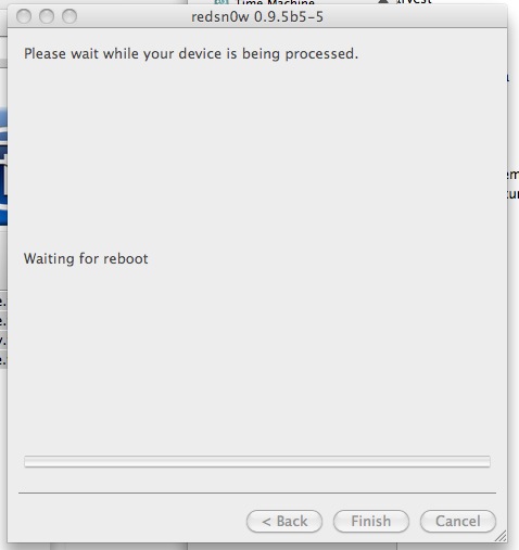

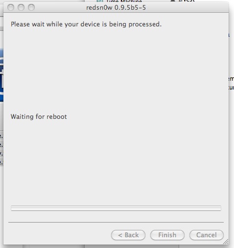

I decided to use redsn0w but it hangs at the waiting for reboot section. Tried different USB ports, different computers, different versions of redsn0w. Won't get past that rebooting part.

At the end of Redsn0w, use TinyUmbrella to kick it out of reboot mode. It should be jailbroken. If Wifi is still not working, sounds like a hardware failure to me.
It doesn't get through the JB process though - no uploading data to the phone, no pic of the pineapple etc.
