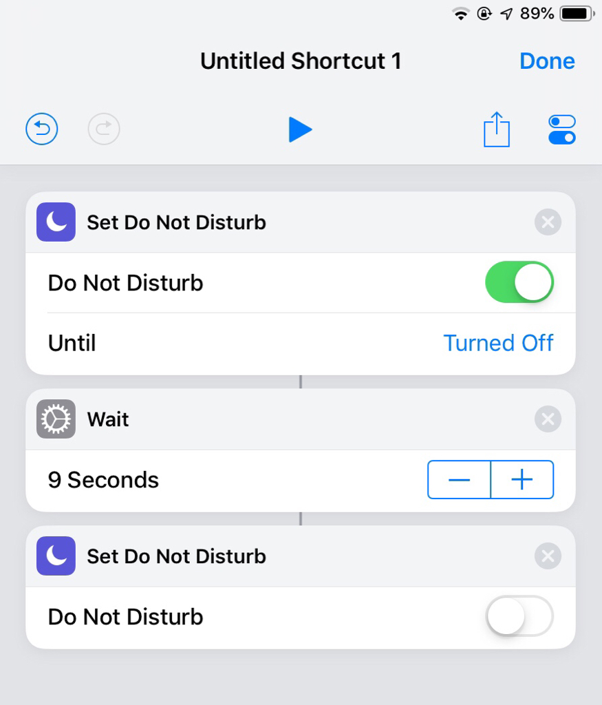

Awesome! Can't thank you enough, the Alarm 'on' function works perfectly.
Now....is there a way to add to this Shortcut the opposite actions at exactly 7:45AM when the Alarm goes off? So the flow would be like this:
[I tap the Nite Time Shortcut and...]
1. Reduce Volume to 0%
2. Reduce Backlight to 0%
3. Enable Do Not Disturb
4. Enable Alarm set for 7:45 AM
[Then the Shortcut would do nothing until 7:45 AM and then...]
5. Increase Volume to 100%
6. Increase Backlight to 50%
7. Disable Do Not Disturb
Is it possible to create a Shortcut with this type of 'delayed' action and, if so, how?
There is a ‘wait’ action that lets you pause for a specified number of seconds before continuing.
Ah, so the Shortcut would pause all night (lots of seconds!) and pick up again in time to turn everything off. Nice solution!
And there’s a “number” input you can select which lets you specify a number. There are 3600 seconds in an hour so just multiply that by the number of hours you want to pause for. Set the “number” input to that and then pass the number to the wait action.
Hope that makes sense! I’ve only played with shortcuts a little so I’m familiarising myself with the terminology still.
Is there any site I can visit that explains how to use shortcuts. It’s totally unintuitive. How do I start...?
So this ️ (it does work but the big downside is you have to press the “add” button a very long time to get even to 3600. Might be better to use “ask when run”)

Does anyone know if there are Shortcut commands for:
Keyboard Clicks to 'off'
Lock Sound to 'off'
Thanks.
Thanks. Is there a glossary for these commands? No idea what an "ask when run" means or what it does.
Apple has documentation for Shortcuts. I don’t have the link offhand but it’s in one of the other Shortcuts threads.
Re “ask when run” that is simply a prompt for you to enter something (a value, text, etc..,) when the Shortcut is running. In the case of the screenshot below, I tapped “1 second” on the dimmed out part and got the option to pick “ask when run” allowing me to insert a “seconds” value while the Shortcut is running, rather than building it in.
Reactions: boltjames
You can only turn volume (system) on and off presently. I’d like that one too!
Damn, thanks.
For my "Night Time" shortcut all I need is a way to turn off Keyboard Clicks and Lock Sound so I don't have to flip the mute side switch every night.
Silly idea- is there a way to use a third party app that can turn those two Sound features to 'off' and then create a Shortcut action to trigger that? Or is there no app out there that can turn those 'off'?
