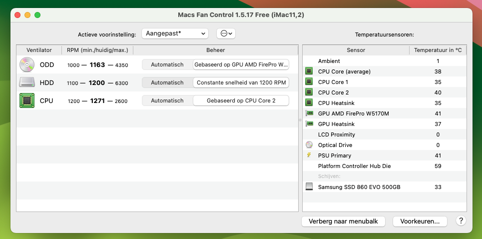

Hi there, I recently opened up my 2010 iMac 11.2 and installed a "Metal" GPU.
Everything seemed to have gone very well, although I had some Fan issues that I "corrected" using Macs Fan Control.
Upon closer inspection it appears that the "Ambient", "LCD proximity" and "Optical Drive" values are erroneously low, often 0 or 1 degrees Celsius although the "Ambient" does eventually rise from 0 to about 20 C. The values were correct prior to taking the machine apart.
Edit: iStat reveals that my 3.06Ghz dualcore CPU is restricted to 1.2Ghz right now too.
Google tells me HDD temp connections (I am using an SSD), sensor cable connections, slightly damaged board solders and similar are suspects.
I will open up the machine but it would be nice to know if the symptoms match one particular scenario to narrow down the effort.
Does anyone have the diagnosis for the symptoms?
Thank you very much,
Paul
Hello,
So I’ve loosened and reinserted the plugs for the LCD Proximity and Optical Drive sensors. Everything looks okay.
Unfortunately the Ambient/LCD Proximity/Optical Drive sensors still show incorrect values (LCD and Optical Drive typically show 0 or 1 degrees celcius).
Macs Fan Control will control the fans perfectly (without MFC the fans spin at full speed), but the most pressing problem is that the CPU is severely throttled when sensors are impaired.
Does anyone recognize this situation and know what the common failure might be? Or possibly a workaround to unthrottle the CPU?
Thanks,
Paul

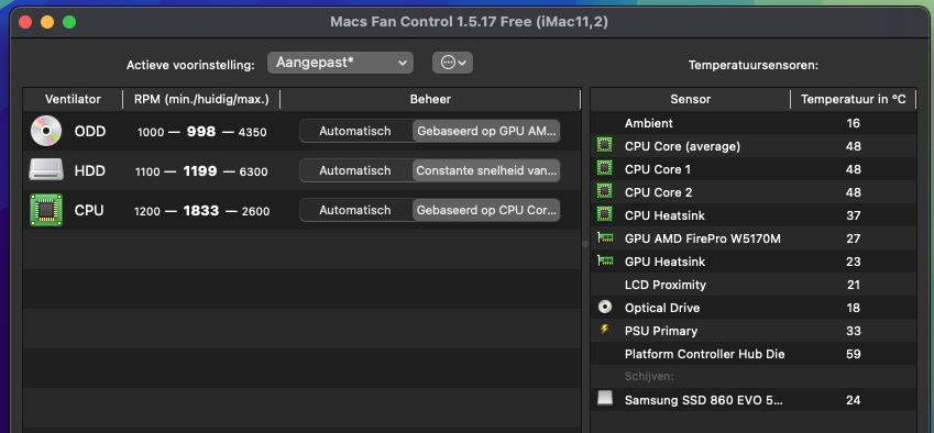

Update:
I finally modified my AMD W5170M (desoldered the 2 jumpers that cause problems).
Machine runs perfectly!
