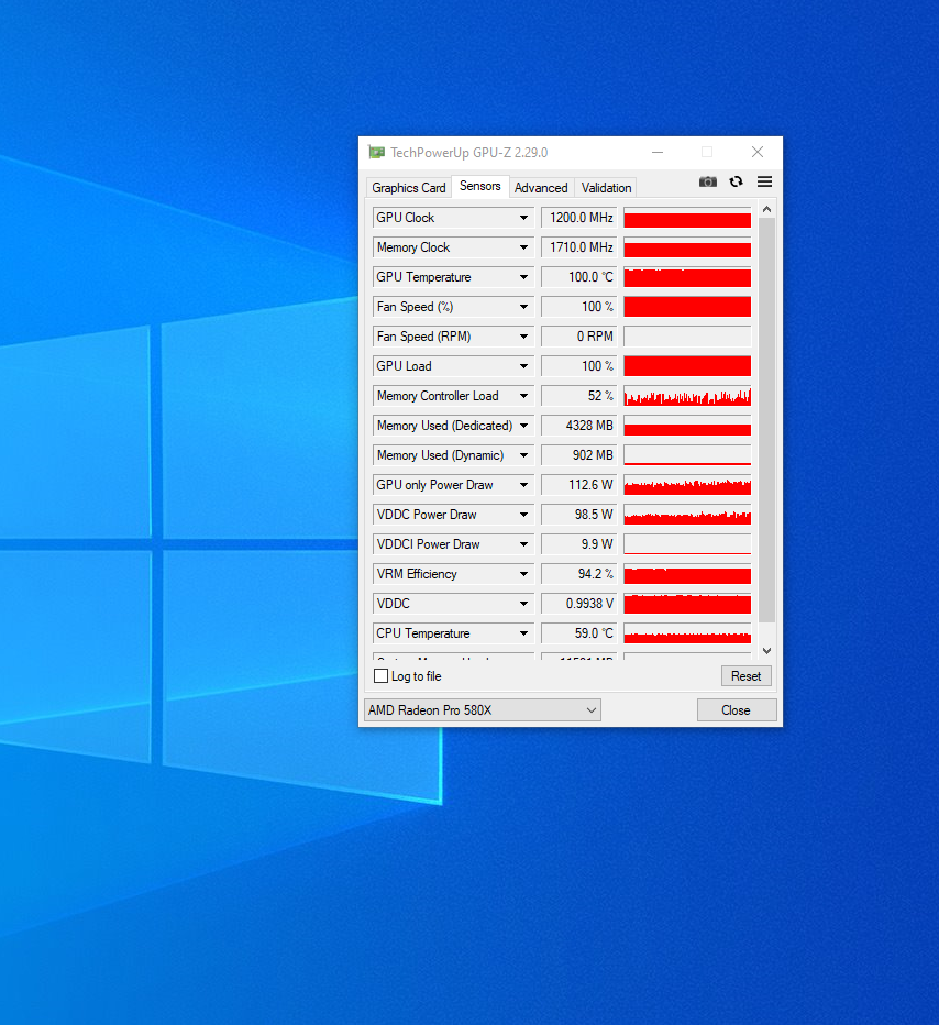

So just got my Mac Pro a few days ago and decided to test it out with a bunch of games, benchmarks etc..
Was playing Red Dead Redemption too and saw that the temperature got up to 102 celsius. It didn't throttle at all and the fan speed kind of picked up slightly.
Is this normal operating temperatures? I tried to download Fan controller but it doesn't detect the Mac Pros fans.

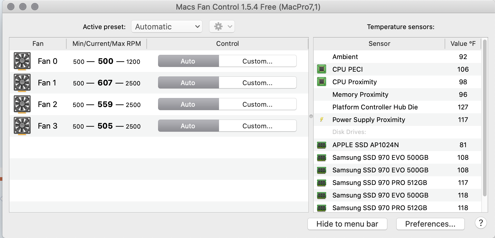

I have Macs Fan Control 1.5.4 and it detects the Mac Pro fans. It doesn't detect the GPU temp, though.
^^^^I have it also, and just for fun, I changed the speed of one of the fans, and the fan did react to that change.
Lou
Lou
How is that? On the MacsFanControl website, it shows that imac and 7,1 mac pro are not yet supported.

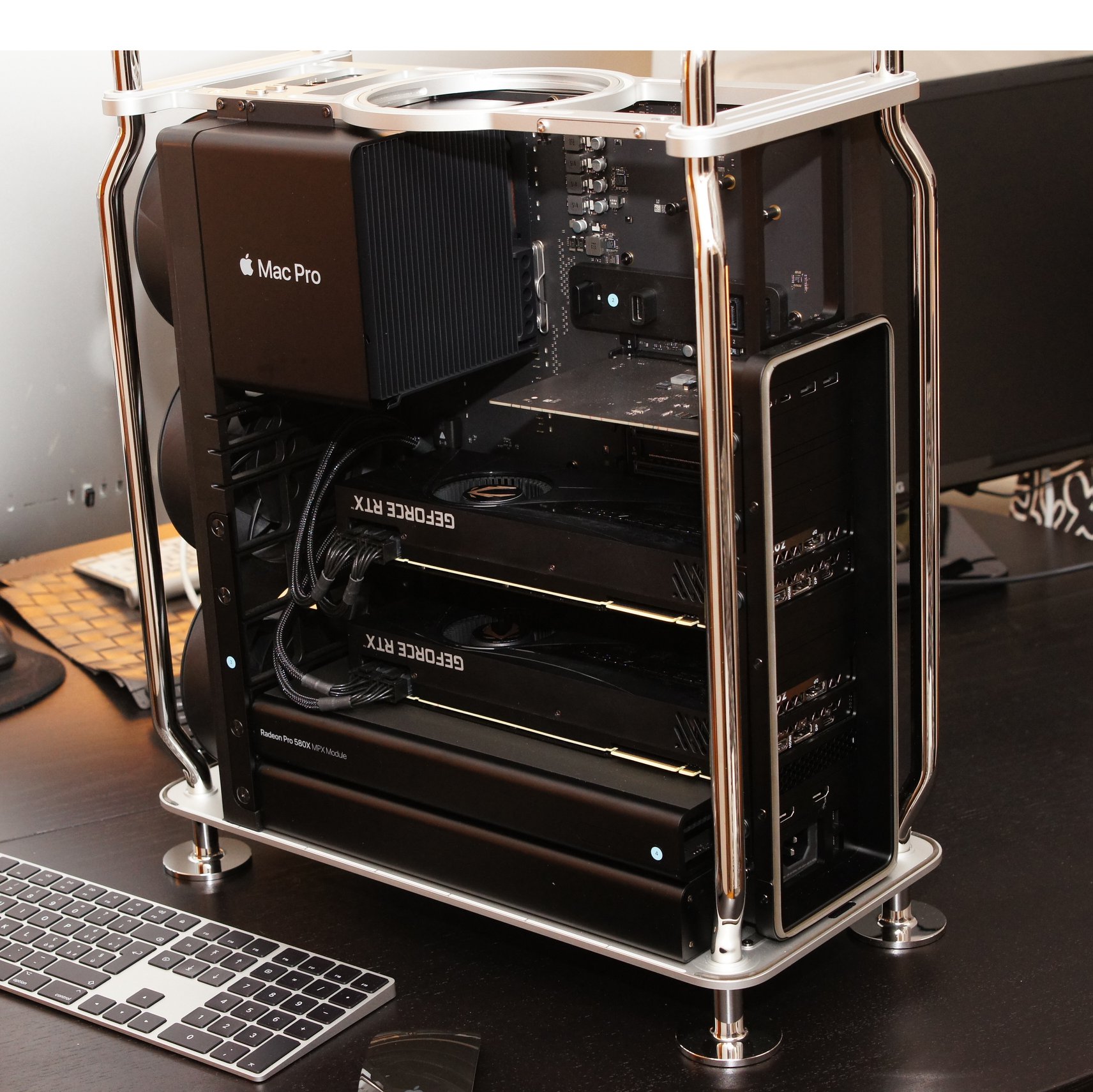

Macs Fan Control doesn't work with Mac Pro 7.1 and Bootcamp
I alredy tested it because I installed 2 RTX2080Ti in the Mac Pro and I'd I like to push more air inside this case. Fortunately I can create custom curves for the Nvidia gpus because I overclocked them but the ventilation inside this tiny space is not ok for blowers. The Nvidia gpus need more air on the back.
"Not supported" not necessary means "doesn't work". Just not officially supported, and no guarantee can work, and they may not react to your report / complain. etc.

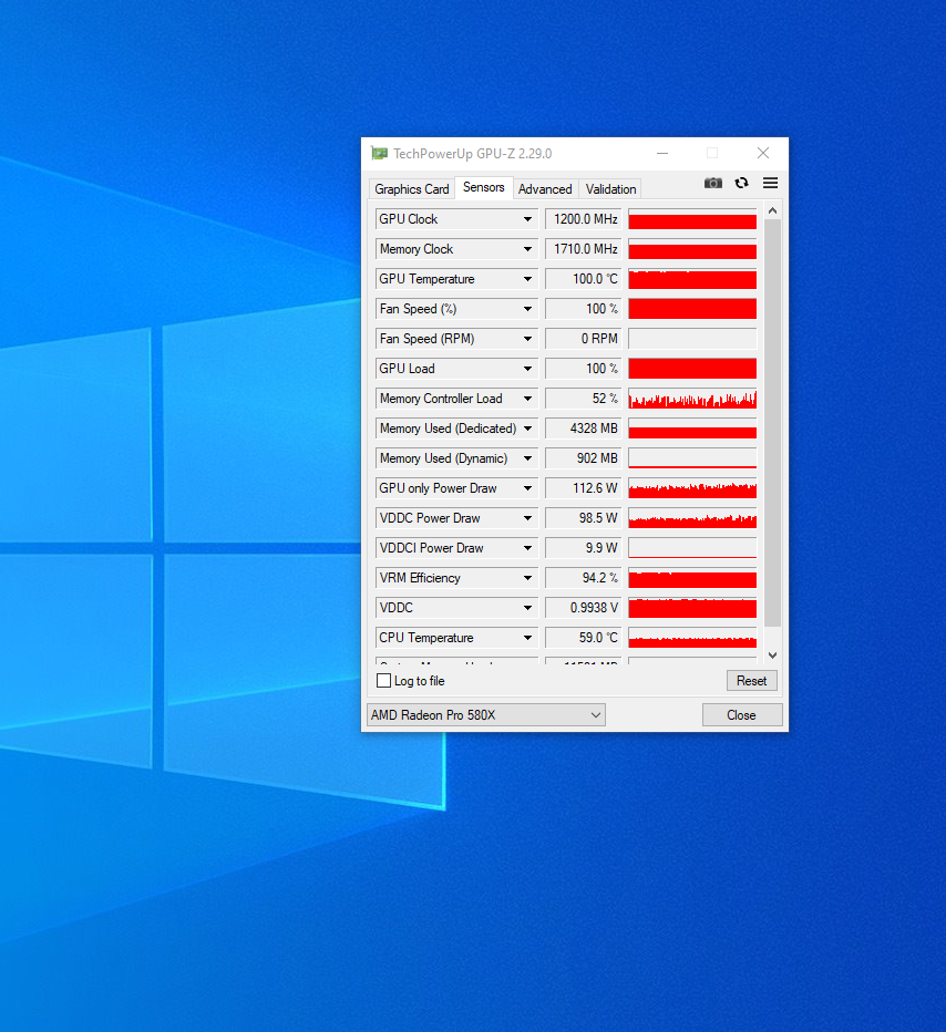

It seems your GPU's fan has died . The Windows utility GPU-Z reports it is operating at 0 RPM . That should not be happening if your GPU chip is 100 C hot . Have you visually verified that the fan is spinning ?
Isn’t the Apple 580X only has passive cooling? I thing that 0 RPM actually make sense.
Radeon Pro 580X has no fans. Msi Afterburner sees there is a fan but isn't plugged because Apple/AMD modified the design, on the pcb probably there is the plug for a blower fan. Also on my RTX2080Tis, made by Zotac, Msi Afterburner reads a second fan. I think the pcb has two plugs for the fans but my version has only one blower. The RTX reference design has two fans, then the blower versions have the same pcb with just one fan plugged.
