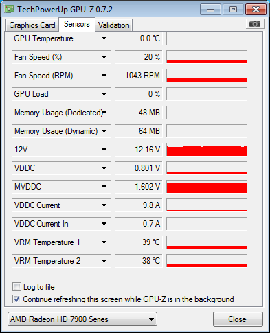

after installing windows and running catalyst software, I can see that the card doesn't return any temperature or power usage info. In win, I can manually adjust the fan speed but that doesn't help me in mac os x.

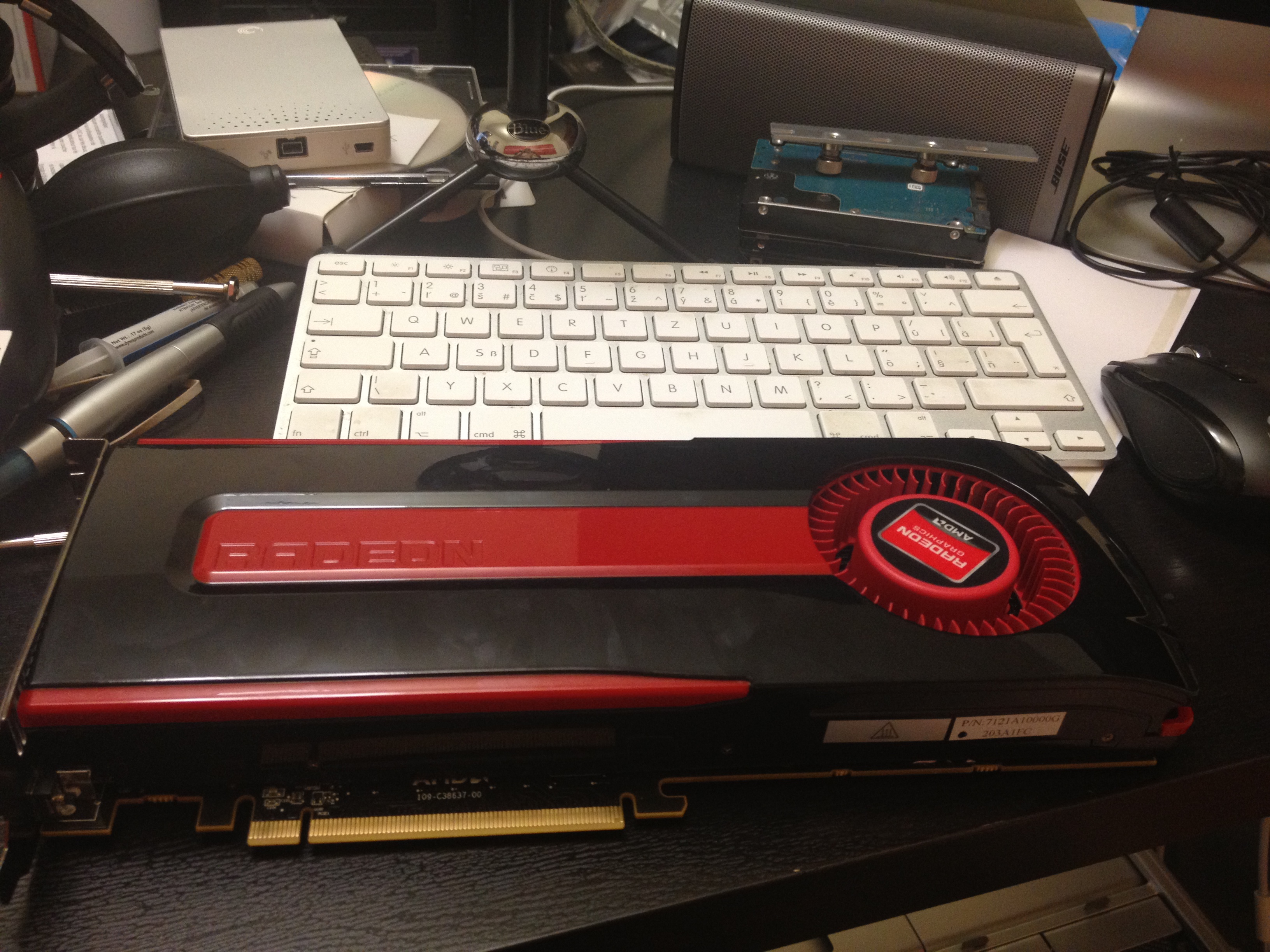

exactly which card do you have?
take pics of the card and post here, preferably the model numbers\part numbers.
techpowerup has a VGA database, so maybe if you post pics we can see exactly what card you have, then make you an EFI BIOS.

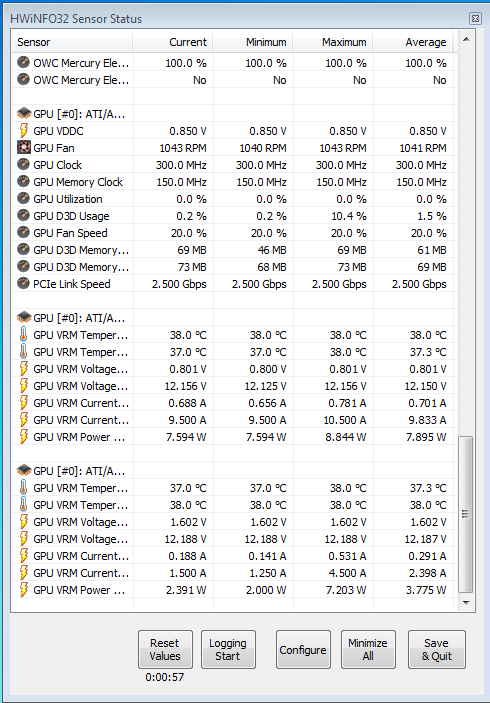

I tried techpowerup's rom already and got boot screens and everything but overheating was still there. I just dont understand how come Catalyst and GPU-Z can't read the temperature but HWiNFO can.

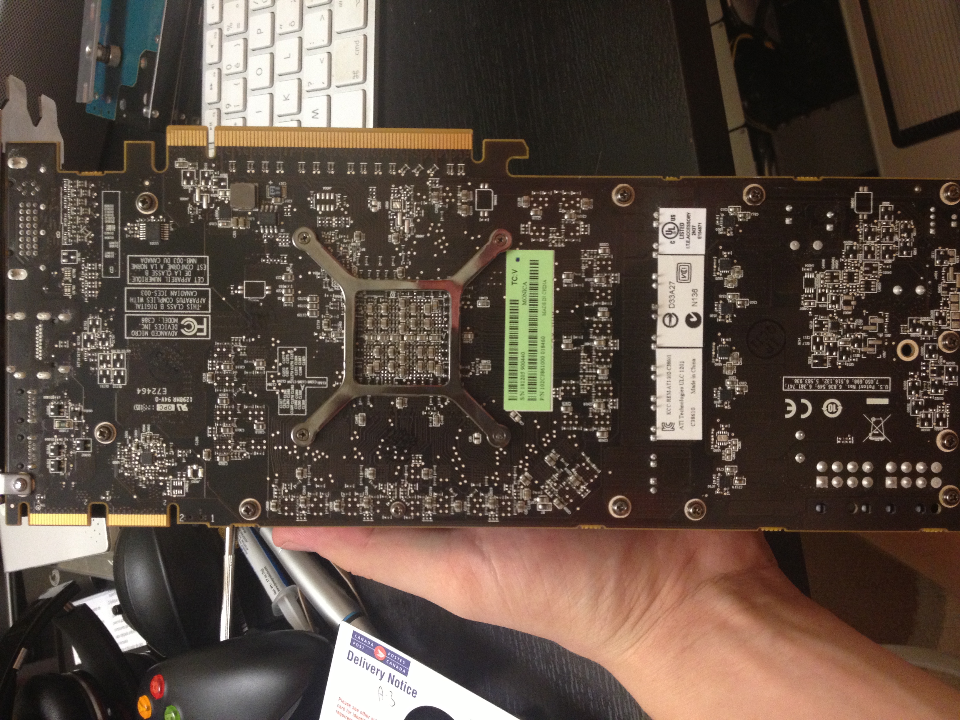

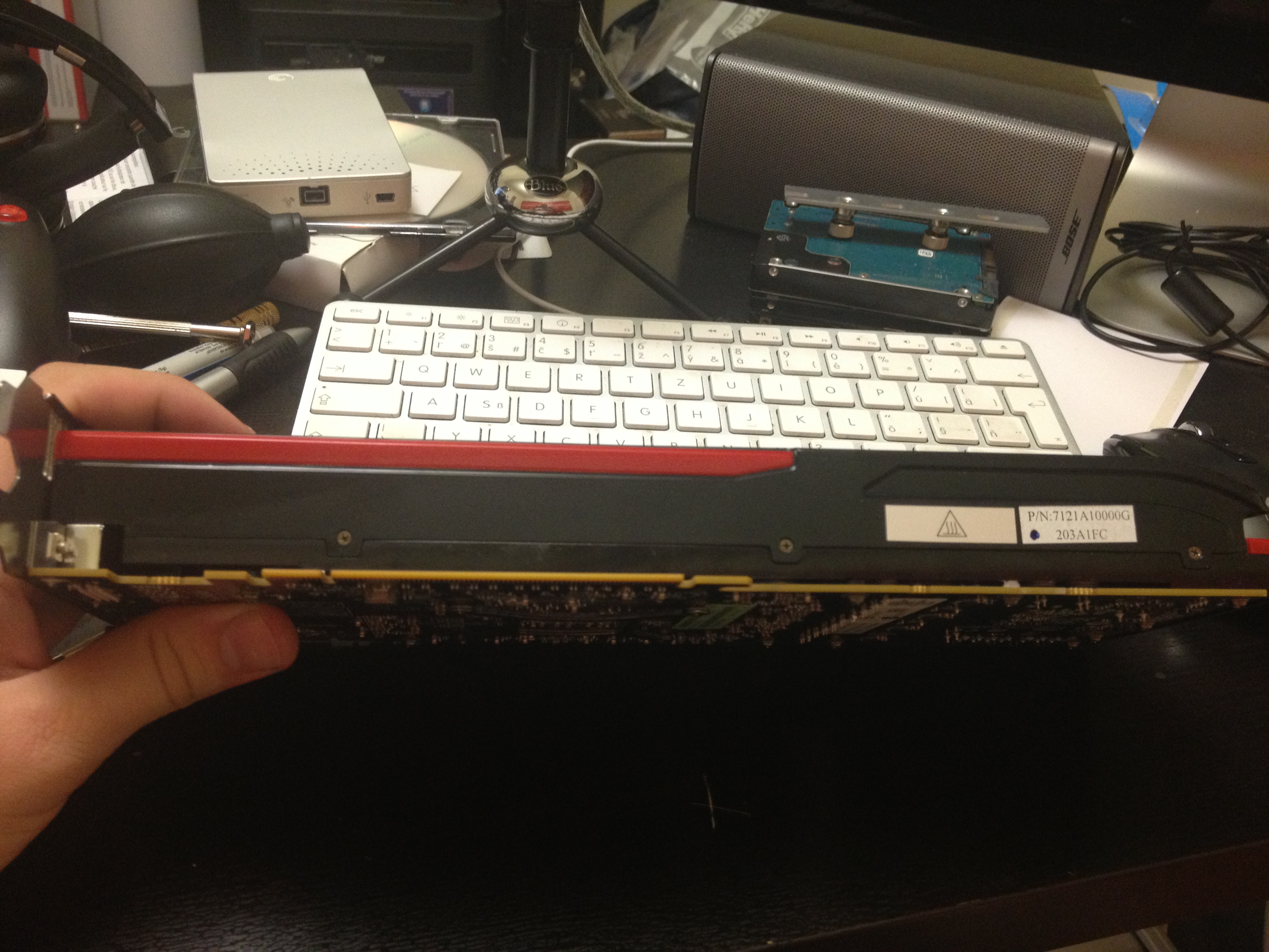

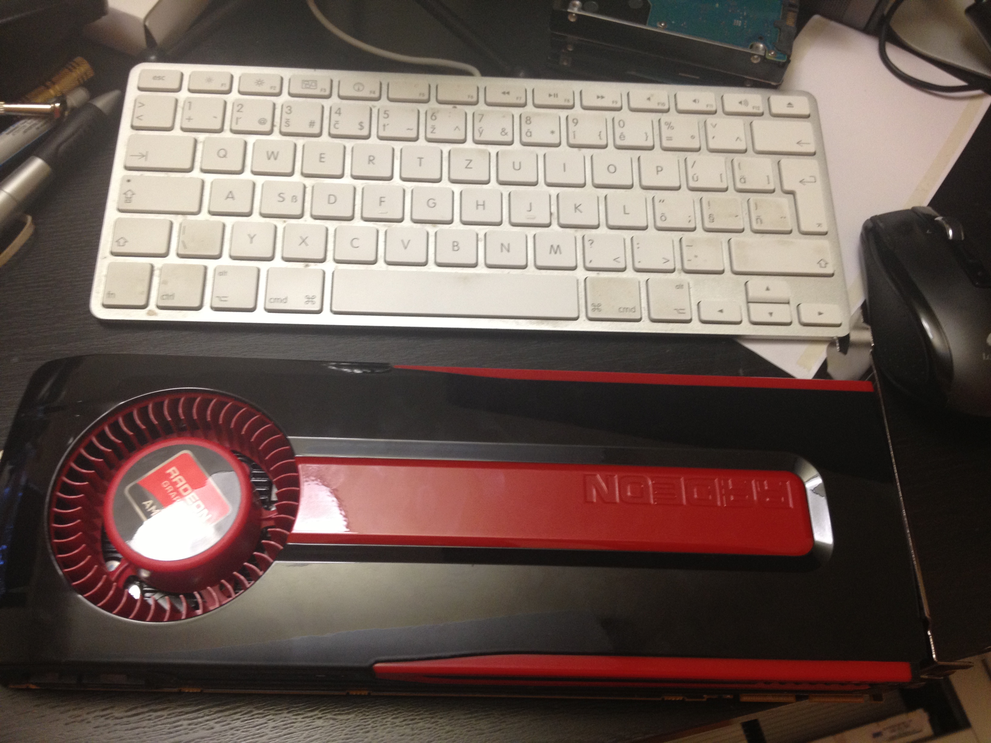

Here are the pics of my card. It's the 679a model, reference design from amd.

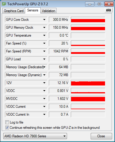

If temp isn't being reported, may be a failure of card temp sensor.
yea I tried RBE but it doesn´t support roms from 7XXX cards :/ If there is another way of setting the fan speed to a set value, I would definitely try it. Using HWiNFO, and its readings from sensors for current temperature and power usage (because as I said earlier - no other program can read them) I found that 40% fan speed will cool the card enough to for it to stay at 45-47 degrees Celsius even if I play full hd movies on 2 monitors in full screen.

The temp sensor is not being found by the ROM, and it thinks it is running at 0C.

now after trying 6 different roms, I can confirm that not a single one was returning the gpu temperature.
