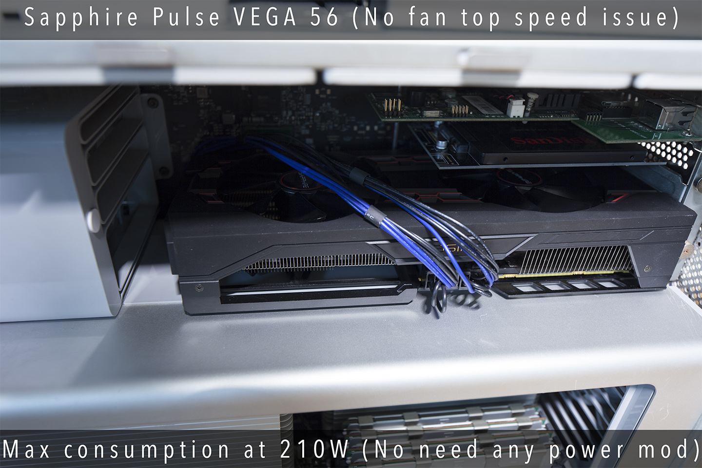

Sapphire Pulse Vega 56 in a Mac Pro 2010 (5,1). Xeon 3.46GHz 12 core, 64GB RAM. Mojave 10.14.4.
  • No fan top-speed issue. It turns on when it needs. Most of the time both fans are off automatically if the environment is cool (my room).
  • Just direct plug-and-play. No need any power-related modification. It just works out.
  • The card is 28cm long. It can fit into the PCI bay flawlessly. No need to remove the PCIe fans in the front.
Under LuxMark OpenCL Stress Test Full Load. Watt consumption is.
  • PCIe AUX-A = 12.3V x 6.79A = 83.5W
  • PCIe AUX-B = 12.3V x 7.99A = 98.2W
  • PCI slot = 12.3V x 1.65A = 20.2W
Max practical power consumption of Sapphire Pulse Vega 56 in my Mac Pro 2010 (5,1) = 201.9W. On AMD website, it is rated 180W.

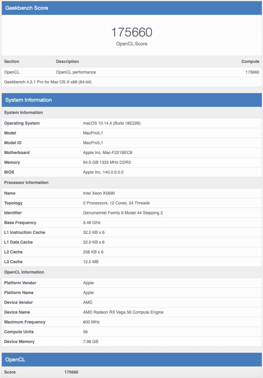

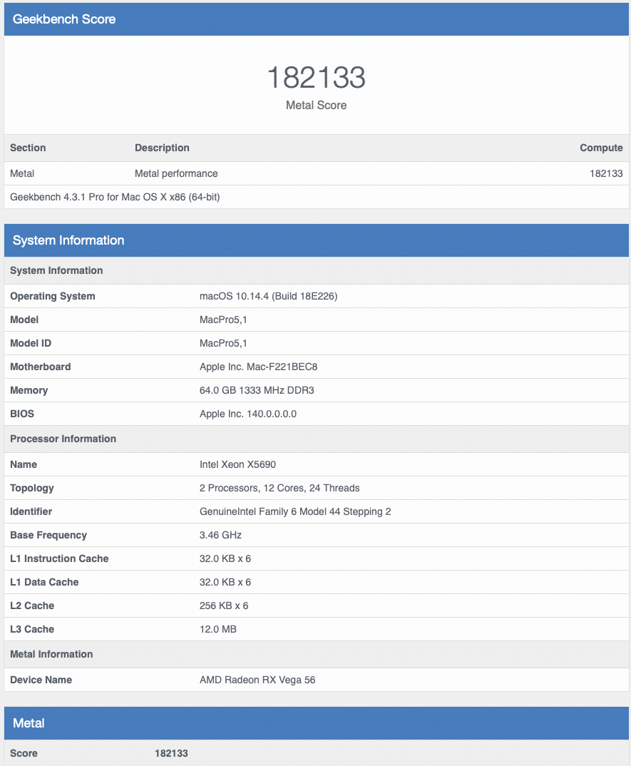

Here is the metal score by Geekbench 4.
Here is the OpenCL score by Geekbench 4.

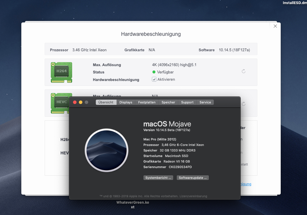

I'm a Final Cut Pro user. I have some findings. When export a movie using h264 coding. It can fully draw the GPU power at full loading. The Xeon CPU loading (usr) would become lower. I can tell because it draws 4A on each PCI-e AUX-A and B port. The export speed is fairly fast. However, when export a movie using h265 (HEVC) coding. Final Cut Pro wouldn't make use the GPU performance but from the Xeon CPU. I can tell because it draws less than 1A on each PCI-e AUX-A and B port. It seems that this card doesn't process h265 hardware acceleration or encoding feature by Final Cut Pro. The export time of a movie using h265 is 5 times longer than h264 in Final Cut Pro X when exporting the same length of movie clip.
To all Final Cut Pro users, be aware.
