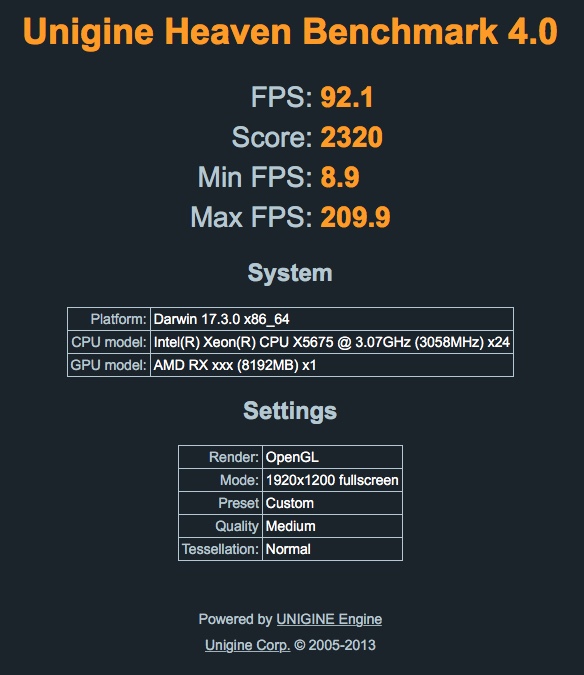

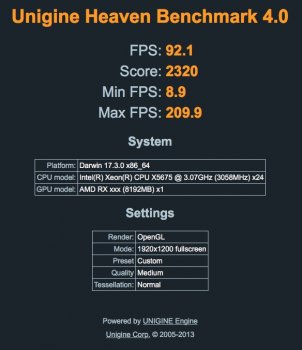

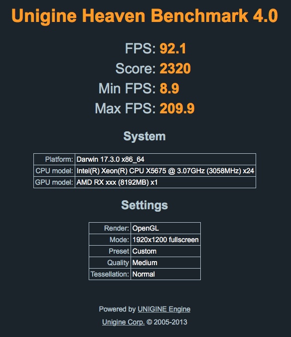

LuxMark luxball score (Mojave): ~5500
Radeon Pro WX 4100
Pros: Low power consumption (50W), good for 2D workloads (CAD)
Cons: Not good for 3D workloads or gaming
Other considerations: single slot width, requires no power cable
Mid-level cards:
Sapphire Pulse RX 580 8GB
Pros: Recommended for Mojave by Apple for Mac Pro 5,1, quiet (zero RPM 'fan stop' at idle feature)
Cons: Less powerful than Vega except in certain apps, relatively poor efficiency for performance (225W)
Other considerations: Version 1 has single BIOS, version 2 has dual BIOS, single 8-pin power connector requires dual 6-pin to 8-pin cable, some users have reported that the card is slightly wider than 2 slots so the fans may interfere with a card installed in PCIe slot 2
LuxMark luxball score (Mojave): ~15,000
Additional info: Two early variants of this card were included with Apple's External Graphics Development Kit and Apple created a specific frame-buffer personality for them called Orinoco which provided enhanced compatibility. See this thread to modify your Pulse RX 580 to use the Orinoco frame-buffer.
Higher-end cards:

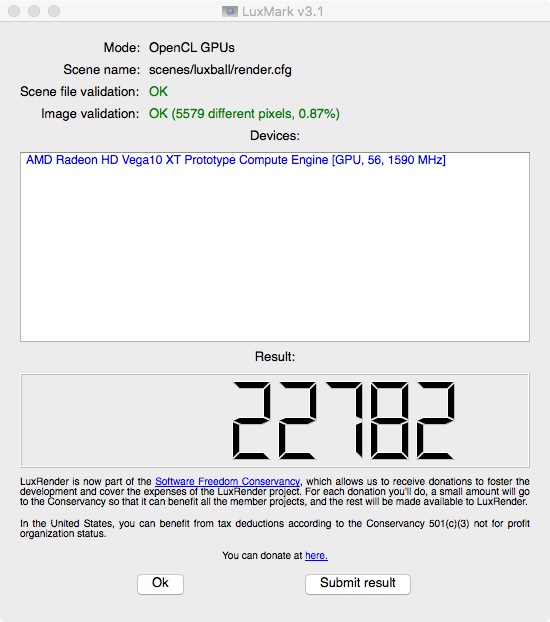

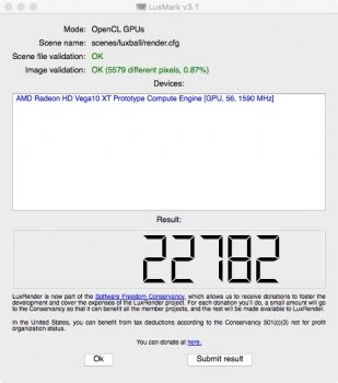

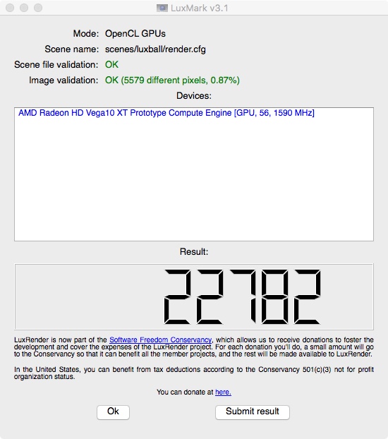

Sapphire Pulse RX Vega 56
Pros: Powerful, very efficient for Vega (180W), quiet (zero RPM 'fan stop' at idle feature), low temperatures, readily accepts BIOS flashes
Cons: 2.5 slot width blocks PCIe slot 2
Other considerations: Dual 8-pin power connectors require Pixlas mod or separate PS.
LuxMark luxball score (Mojave): ~28,000
PowerColor Red Dragon RX Vega 56 (also sold as Dataland X-Serial RX Vega 56)
Pros: Powerful, very efficient for Vega (180W), quiet (zero RPM 'fan stop' at idle feature), low temperatures, 2 slot width
Cons: Users on other forums have reported that a different BIOS cannot be flashed to this card and the failed flash cannot be recovered.
Other considerations: 8-pin + 6-pin power connectors require Pixlas mod or separate PS.
Reference RX Vega 56 and 64
Pros: Powerful, 2 slot width doesn't block PCIe slot 2, readily accepts BIOS flashes (e.g. 56 to 64)
Cons: Fan can get loud, no zero RPM 'fan stop' at idle feature
Other considerations: 8-pin + 8-pin power connectors require Pixlas mod or separate PS. Requires macOS 10.14.5 or higher to be free of high speed fan issue.
LuxMark luxball score (Mojave): ~26,000-31,000

OpenGL issues appear to be resolved with RX Vega 56 GPU. Google Chrome now works well with hardware acceleration and WebGL enabled.
Preview no longer crashes when attempting to crop a photo.
[doublepost=1509605442][/doublepost]The LuxMark v3.1 luxball score increased by 2531, from 20251 (on 10.13.1 beta build 17B25c) to 22782.
[doublepost=1509605956][/doublepost]Also, on previous builds sometimes a window would flash solid red when minimized or the section of the screen would be solid red where a crashed window was. So far that no longer occurs.

Thanks for the tip. I tried it. It didn't work.
