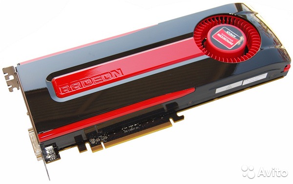

Have bought HIS 7970 for $90. Used, of course.
Looks identically:
images
Then flash it under Windows with EFI Rom (downloaded on some forums).
Ta-da — bootscreen shows up. But only PCIe 1.1 — 2.5 GT/s.
Manually deleted small R17 transistor with a flat-head screwdriver.
As the result — PCIe 2.0 enabled and 5 GT/s transfer rate.
Test:
Cinebench R15 43fps. Poor, because OpenGL performance depends on single core performance. I've 2xX5660. They super as 12-core 24309, but low at 1-core 2327.
Heaven Extreme 1600x1900 — 774 points. Min 7.4 fps, max 71.1 fps.
Compare flashed Palit GTX680 4Gb — 908 points. 7.7 » 80.1 fps
Valley Extreme HD — 1393 points. 18.6 fps » 60.6 fps.
Compare flashed Palit GTX680 4Gb — 1481 points. 18.5 » 64.0 fps
Impression — great videocard. Of course, if don't need CUDA, but only Open CL.
