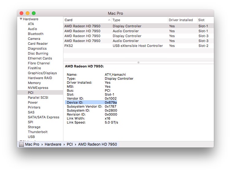

Look up the device ID, e.g. with GPU-Z.
It should work in OS X in any case, since all HD 7800 are supported. It depends on the exact model if it can be properly flashed for boot screens though.
About This Mac -> System Info
