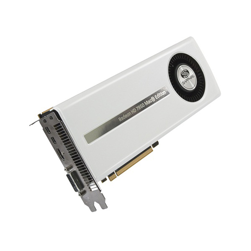

Update: I just saw what the "Mac Edition" card looks like (all white) and the card in this machine is red, so I guess it must be flashed.

OP , do you have an actual picture of the graphics card ? That'll help to determine its identity (genuine Mac Edition or a flashed PC card .)
If it is a flashed PC card (and if it's not a reference flashed PC card) , there could be an issue with port mapping in the ROM . Or, it could just be a badly flashed PC card .

Genuine Mac Edition AMD 7950 cards look like this :
You obviously have a flashed PC Card . You need to contact the individual who flashed the card or re-flash the card yourself .
