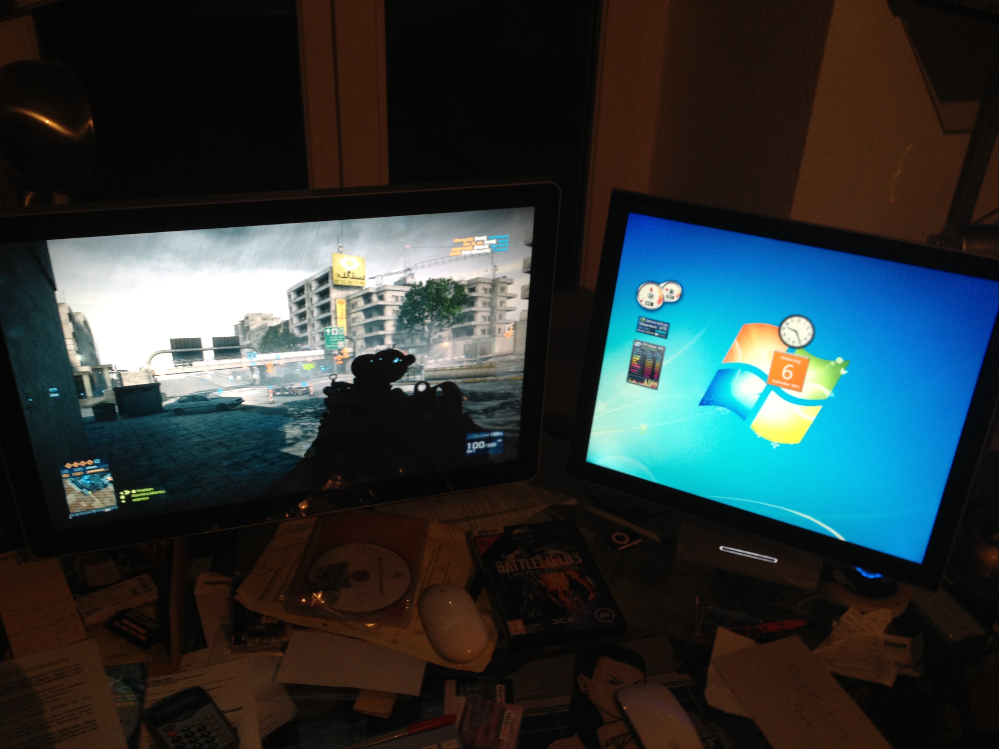

No, I don't really *need* the GT120. I use it so my second screen doesn't blank when I'm playing games. It's useful for some things, like temp monitoring apps (not that my Pro runs hot really, I just like to see that sort of thing, also FPS numbers, etc).
Playing BF3 on Ultra 1920x1080
Having a sceondary screen on with some gadgets (GPU/CPU temp and use and some more stuff)
