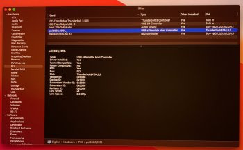

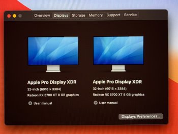

I got a 2nd Pro Display XDR and to my surprise I got both working in 6k. Brightness and USB works on one only.
This is on Gigabyte Z490 Vision D with XFX 5700 XT (switched it back from the MSI 5600XT. I haven't tried the 5600 with both displays although it may work).
To get them both in 6k I added the GC-Titan Ridge 2.0 card. https://www.amazon.com/dp/B08BC11XW8/ref=cm_sw_em_r_mt_dp_DmwGFbF4GA93A
First I got them both working through the GC-Titan Ridge 2.0 card that receives signal from the GPU using the two short display cables provided. However, couldn't get the USB to work to use brightness. The USB hubs on the back of the displays didn't work although I tried connecting the card into different USB headers on the motherboard.
Then I plugged one display directly into the thunderbolt port on the motherboard to get brightness control and USB and it works. One display is plugged into the motherboard and the other is plugged into the GC-Titan Ridge 2.0. I couldn't get them both to work from the motherboard thunderbolt plugs, I guess since there's only one display IN to feed it.
I didn't think the GC-Titan Ridge 2.0 would work for several reasons. The Z490 vision D motherboard isn't listed under supported motherboards on Gigabyte's website. The motherboard doesn't have any Thunderbolt headers (neither 3 nor 5 pin). And there's already a thunderbolt controller on the motherboard.

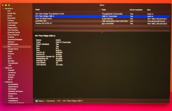

I plugged a few USB C devices in the GC-Titan Ridge 2.0 and some work some don't. For instance the Logitech webcam works, but an external hard drive gets the light on but does not appear in the computer.

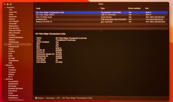

In System Report there's nothing listed under Thunderbolt, but Thunderbolt listed under PCI, see the attached photos. I'm an amateur at best and don't even know if these are installed correctly.
Although I could live with brightness and USB working on one monitor only, it would be awesome to get them both working properly. If anyone has a suggestion as to what I could try doing to get the USB working correctly from the GC-Titan Ridge 2.0 that would be much appreciated.

@npgatech @joevt
No surprises here. Since the displays are connected to GC-TITAN RIDGE, they are using a Thunderbolt connection. Since they are using Thunderbolt, the USB header is not used, and USB can't work unless you get PCIe tunnelling working.
Right. The motherboard Thunderbolt controller only has one DisplayPort input, so only one display can work from the motherboard Thunderbolt port. The motherboard Thunderbolt port seems to be working for you (enabled by motherboard Thunderbolt firmware or because you flashed it?).
You only have DisplayPort to Thunderbolt conversion working. That usually works for any Thunderbolt add-in card no matter where it's connected.
The webcam is USB 2.0 and is connected via the USB Header of the Titan Ridge. The hard drive is USB 3.0 but you don't have USB 3.0 working. On my Mac Pro 2008, USB 3.x from the GC-TITAN RIDGE 1.0 works fine for USB 3.x (it is not flashed, it has 3.3V to the force power pin). Is your card flashed? You have a different GC-TITAN RIDGE 2.0 so it has a different header. Do you have 3.3V to the force power pin? Your PCI list shows both Thunderbolt USB controllers (one for motherboard, for the GC-TITAN RIDGE 2.0) so I don't know why the GC-TITAN RIDGE one doesn't work.
Thunderbolt drivers won't load for either controller won't load unless you do some DSDT stuff (ThunderboltDROM).
Forget Thunderbolt. Use a Belkin charge and sync cable to get both DisplayPort and USB (but limited to USB 2.0) to the XDR.
Do we know if this is really outputting as 6k, or is this just displaying as if it is 6k but upscaling from 5k/4k?
Both in 6k nice and crisp text, but profiles and brightness working on only the one plugged directly into the motherboard. The only way to get the 2nd display in 6k so far is through an add-on Titan Ridge card that was mentioned earlier but without brightness and presets unfortunately.
