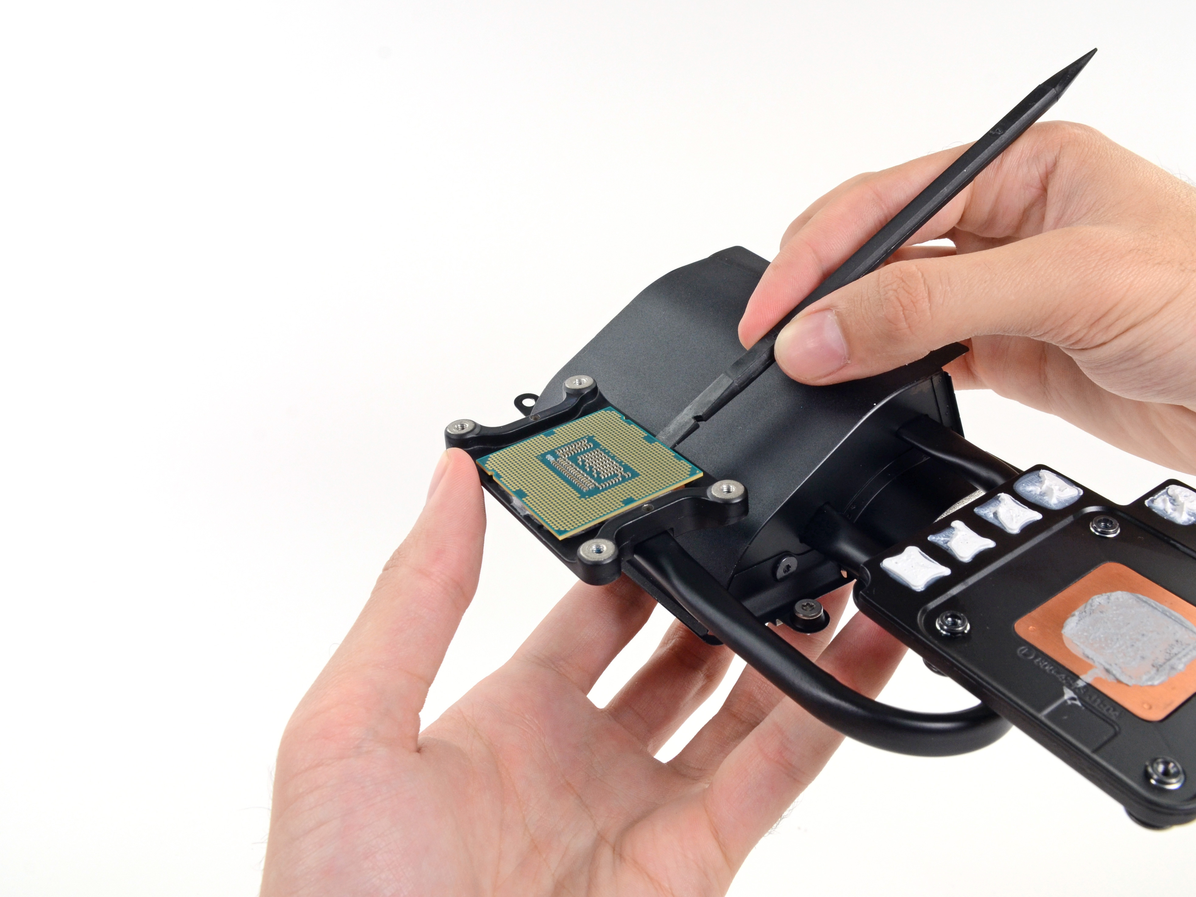

My iMac 5k restarts after the GPU it goes over 95 degrees Celsius. Has anyone find a good thermal pad/paste to replace the existing one? Full story here
R9 m290 2048Mb, i changed the paste that it comes with, to an Arctic thermal pad. This is the culprit, I now have to find out what to replace it with. Anyone knows a good solution? I am considering using a cooper shim to fill the gap between the cooler and GPU which is 1-2mm.

Thanks for the reply guys, but I wrote all the details in that thread. Rams were changed, the CPU is the exact same one they use and a SSD is just an SSD. I am very good with computers, I upgraded at least 5 imacs so thats not a problem. Like I said, i isolated the problem. Its a GPU temperature issue. No software to blame, on both macs that i upgraded I used the same thermal pad and they both give the same results. So i have to find a better cooling pad/paste to replace the Arctic pad. AS5 cannot be used as there is a gap between the cooler and chips, I must use a thicker paste or a copper shim with AS5 on both sides. Other forum users have been doing this mod for laptop GPUs and have seen improved cooling and temperatures.

Anyway, did you check the VRAM and VRM temperature as well? 95C can freeze my 7950, but should not be a problem for your GPU.
However, provided that you get the same error in both self upgraded iMac. And it's temperature related. It may be not the GPU itself's problem but something else.
IMO, if you sure it's the GPU and you want to cool it properly, cooper shim is the way to go (assuming your 1-2mm gap accessment is correct).
I am using iStat and I do not have the Vram and Vrm options of temps. What to you check it with?
Well just a look at the picture from ifixit makes me believe its a 1.5-2mm gap. The only thing related between the two macs is the thermal pad. One is 5k and the other one was late 2013 with Gt755 M of 1gb. I think i will go with the shim. Just hypothetically, is the shim better to be a tad thicker than thinner, right?
