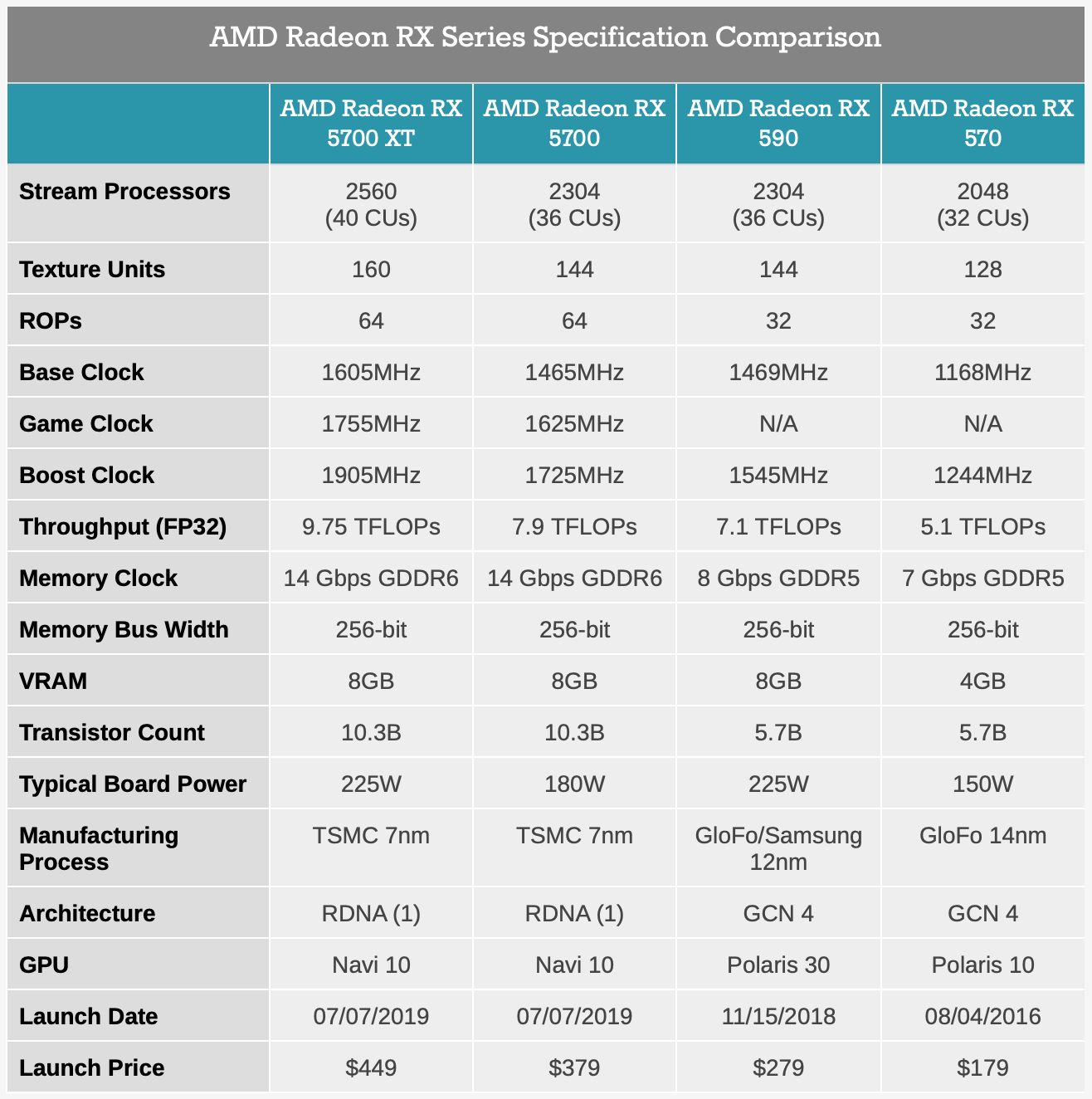

With the launch of the Radeon RX 5700, AMD has delivered an updated card that appears to work within the 4,1 / 5,1 cMP's power capabilities,(75 watts - PCIe slot, 75 watts - PCIe aux1, 75 watts PCIe aux 2) without having to make the power supply mod.
Are there any NAVI based drivers lurking in Mojave? Or is this next generation of graphics hardware destined to be supported only in Catalina?

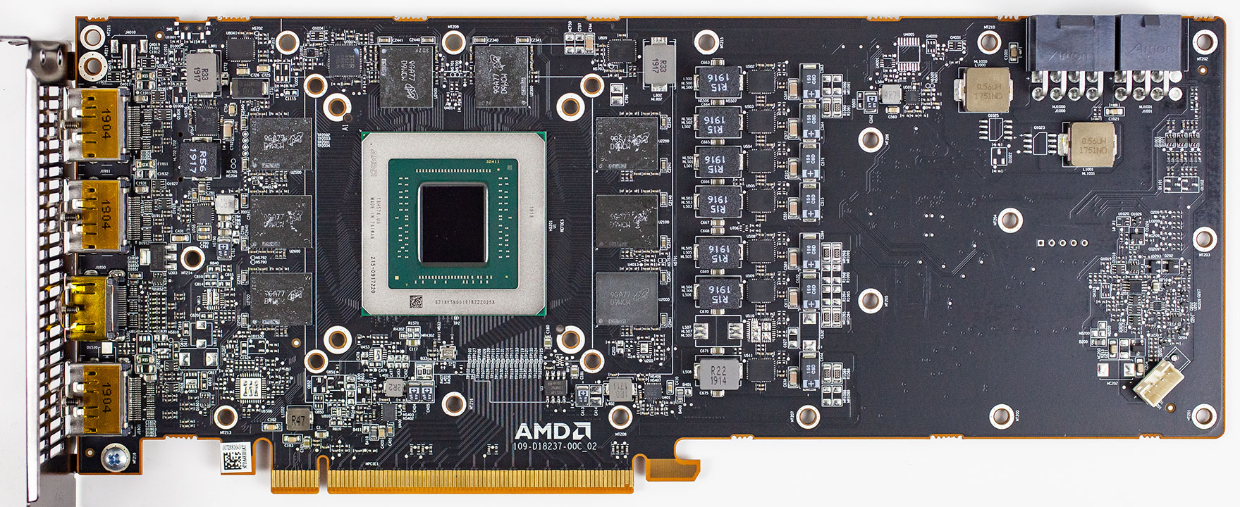

It looks like it has 1 8pin and 1 6pin, isn’t this more than the two mini 6pins can provide from the mb?
Yes, without modification all power pins themselves cannot be "naturally" connected. Unsure if this GPU truly requires the 8-pin or if it has an official option to either not connect (operate at reduced power) or change to dual 6-pin. Realize reports show reduced power load vs. others with 6+8 pin, but proceed with caution.

[doublepost=1562618387][/doublepost]Looks like RX 5700 has SINGLE 8-PIN power and RX 5700 XT has 8-PIN & 6-PIN power. Image above must be the 5700 XT model.
https://www.engadget.com/2019/07/07/radeon-rx-5700-xt-review/
"The Radeon 5700 relies on a single 8-pin power connection, while the XT uses an 8+6 pin configuration."

I'm gonna throw a wild guess out there and say that the 5700 and 5700 XT are the exact same board and, maybe, by flashing the XT bios on the plain one you'll unlock it.

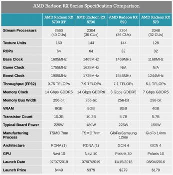

FYI, this chart shows 180W for RX 5700...
https://www.anandtech.com/show/14528/amd-announces-radeon-rx-5700-xt-rx-5700-series
Thx for sharing. 180w is definitely within the capabilities of the cMP based on how the power is drawn.

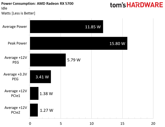

Tom's hardware was the only review that provided an in-depth measurement across all 3 of the 5700's power interfaces using the Powenetics Project windows app. There may be other reviews out there covering this in more detail.
aHR0cDovL21lZGlhLmJlc3RvZm1pY3JvLmNvbS9ZL0MvNzUyOTE2L29yaWdpbmFsL1Bvd2VuZXRpY3MuanBn
Reactions: worldburger

Especially both card has identical PCB, and 5700 clearly doesn't need 6+8 pin. Which feel like both of them are actually identical (physically) but just with different firmware.

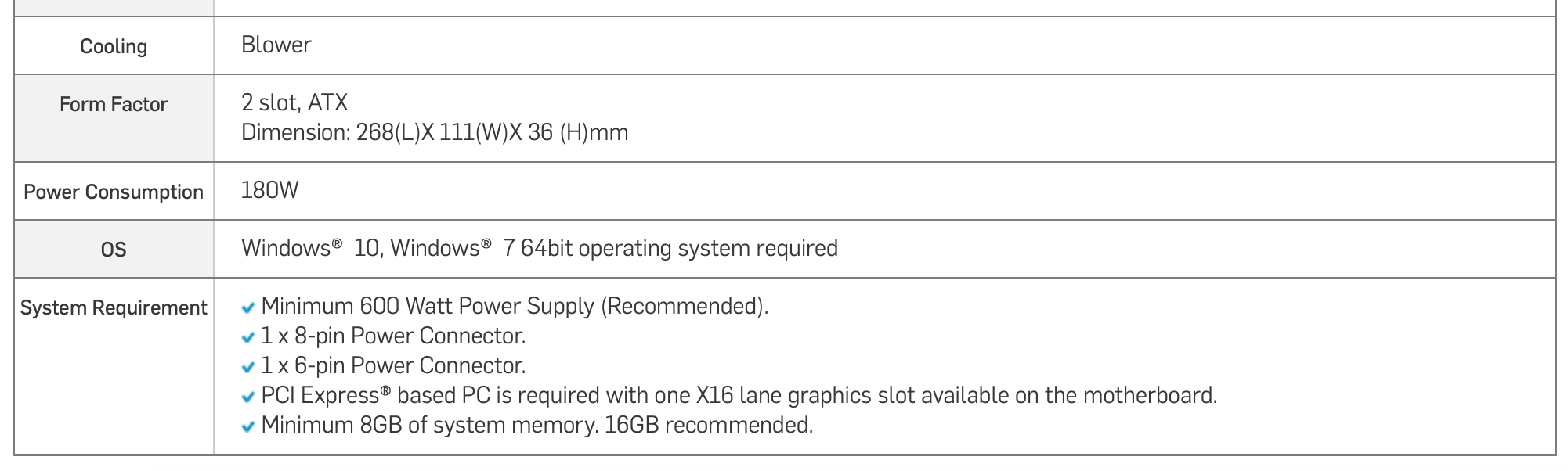

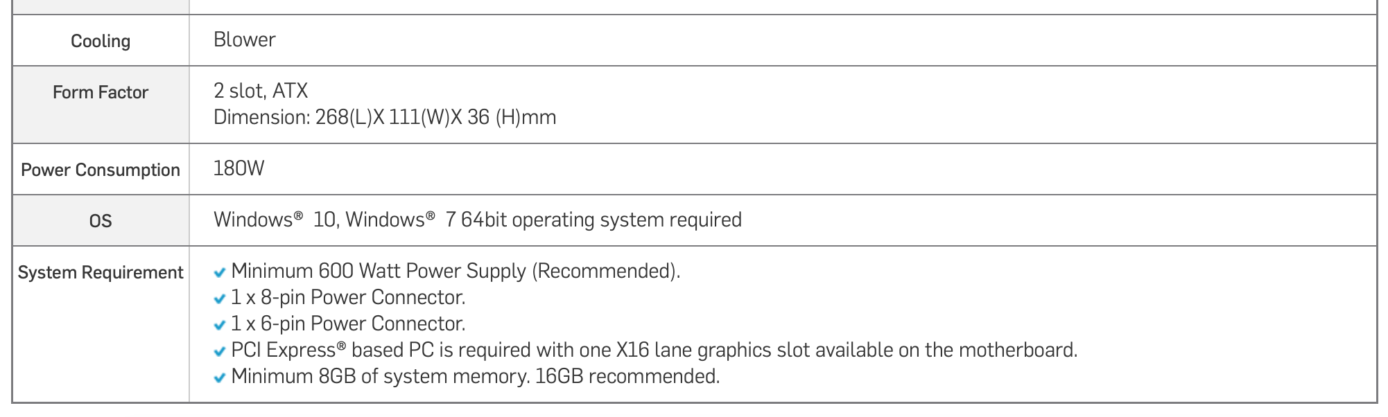

This likely confirms the 180W report from the chart above, however there is no Mac compatibility listed. All product images and descriptions show 6-PIN & 8-PIN power required. Does not appear to include the 6>8 cable and 4>6 cable in the SAPPHIRE version. XFX version from Best Buy lists Mac compatibility and includes "converter" cables (likely NOT mini 6-pin).
