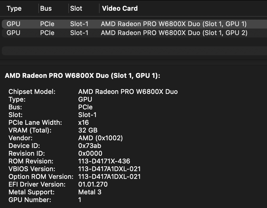

hi Borowski, is it possible you have the duo version of this card? Meaning you have a w6800x Duo?
that one too is not working. Your card is the Radeon pro w6800x mpx? That’s the one I need. Also the file is .sb format. Do I just change the type to .rom?
