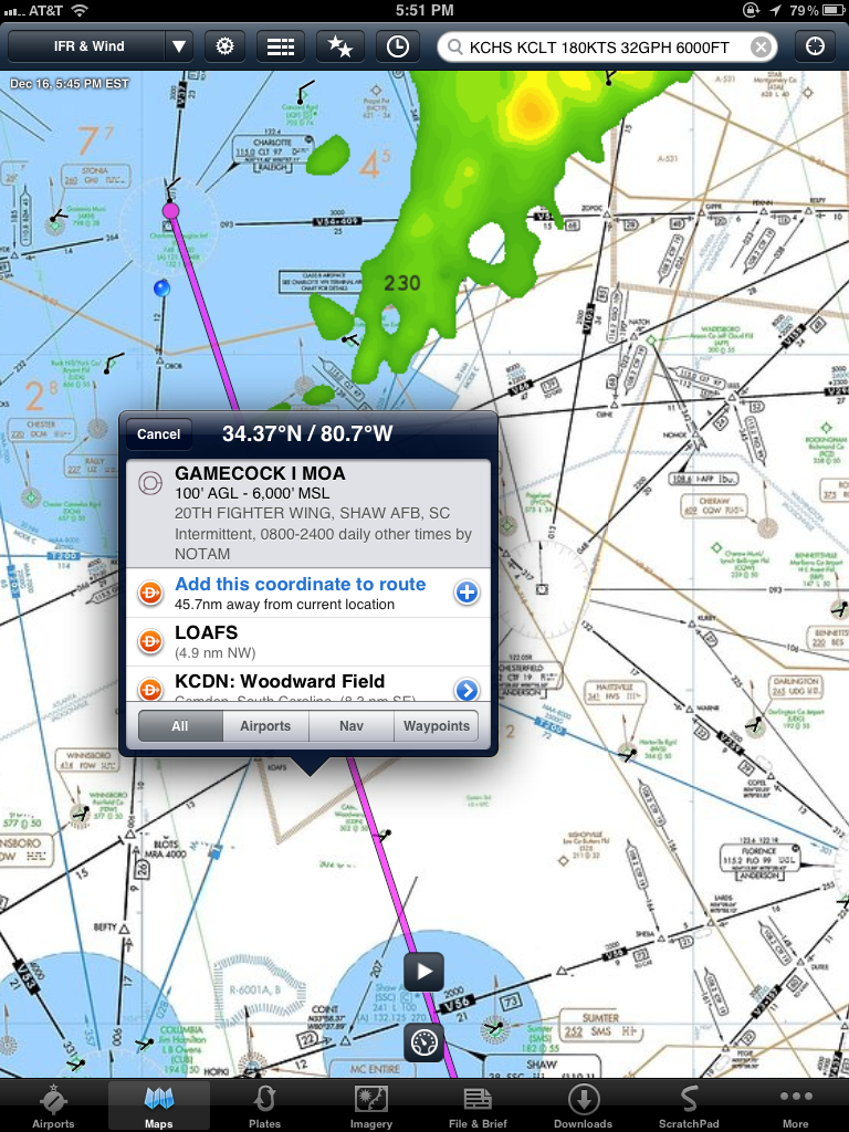

Another item was Winds Aloft. I sent a lot of time considering what alt and direction I should fly to take the most advantage of that bit of info. It would be nice if it suggested the course.
ForeFligth and MyCast did not have notes on MOA either (that I found), had to look in sectional to find that info.
Or for that matter what freq I need to use.
Foreflight does show MOA and other SFOs by simply tapping and holding within the area. Here's a screenshot showing weather, winds aloft and the Gamecock MOA information. Tapping the field show additional information, including frequencies where applicable.

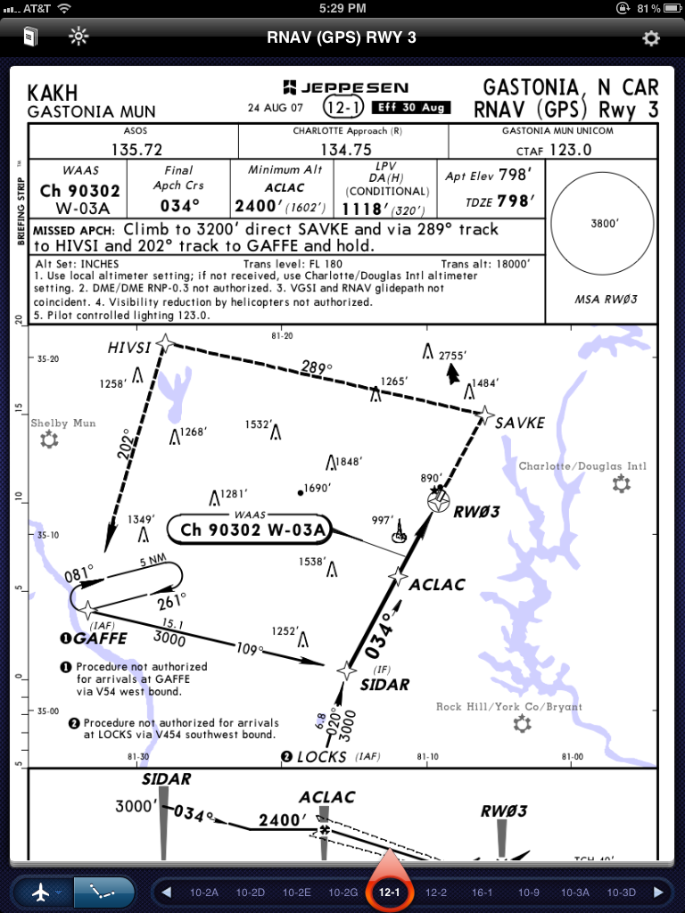

JPEG scans: This app isn't merely a scanned version of the plates themselves. They are vector-graphic based depictions. So, no matter how far you zoom in, the lines/curves will still be sharp and crisp.
To be fair, the 'plates' in the Jepp app are not vector depictions... although they are of high enough resolution for it not to matter. The enroute charts, however, are indeed vector graphics and as you zoom in, more detail appears.
All the other apps that use NOS charts (Foreflight, Garmin Pilot My-Cast, WingX, etc) use high resolution scans for both charts and approach plates.
