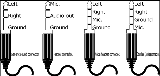

Based on your Signature I suppose you're referring to an iMac , so there's only one (analog) headphone 3.5mm stereo output.
Note that the 3.5mm jack for a stereo output signal plugged into your Mac should have only 3 parts: sleeve, ring and tip.
The connector on e.g. a Macbook /iMac has a 4th connector to use a headset (= mic+ 2 audiosignals ), but for audio a "normal" stereo jack should be used.

The stereo cable is similar to the first one pictured, no mic. I'm not quite sure what you're advising my to change with the connection, as this amp will not work with digital audio output. No SPDIF or similar. I'm only able to output in analog, but are you saying to using a 3.5mm to USB adapter at the end of the setup?
The Macs I am attempting the connection with are a 2010 iMac, 2006 Mac mini. These ones had a dedicated mic jack next to the headphone jack, not sure it changes anything though.

Ok, then the jack is correct and there's a separate input and output jack on your Mac, so the problem is somewhere else I suppose.
