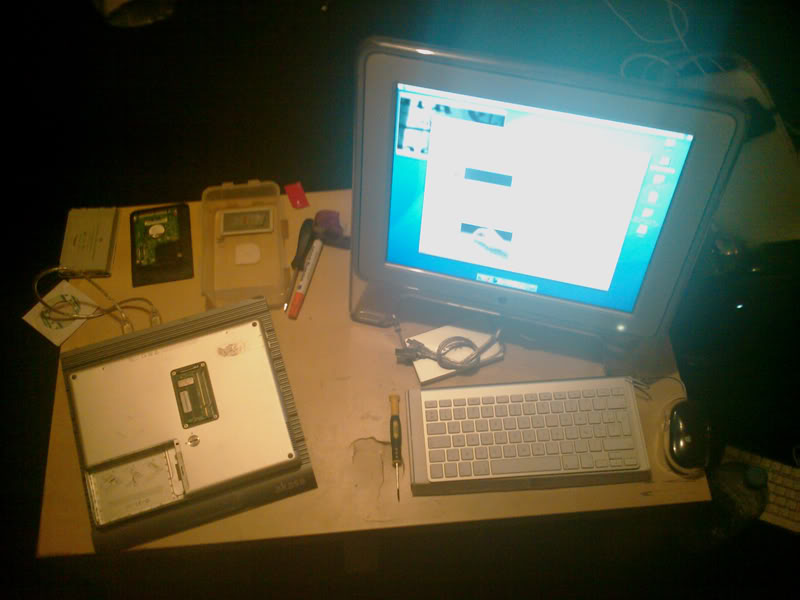

I got my WD Scorpio and USB Caddy, used Carbon Copy Cloner to clone the 250Gb WD from my stock 60Gb (Leopard) here's some pics of the process of taking the laptop apart (not as detailed as the www.ifixit.com guides - which i followed!)
the workspace (living room table!) - heroes on vlc 😉
PowerBook G4 1.33/1.25/250! PowerMac G4 933/1/5/300 xD

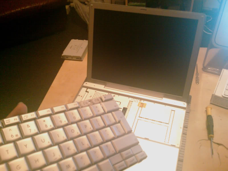

i was really not looking forward to removing the keyboard, the data lead is very fragile! but with care, it comes out easily!

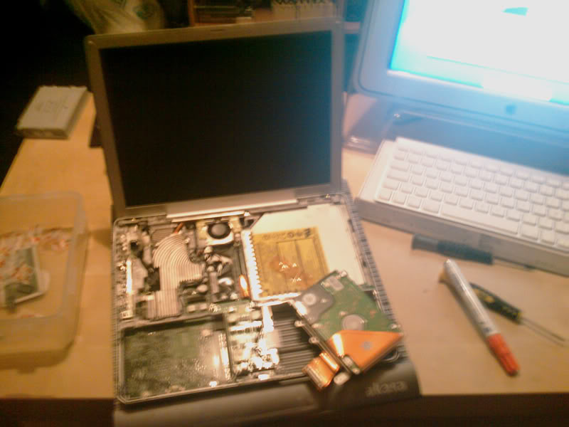

then more screws, (15 to be accurate, my powerbook (second hand was missing 2 screws!!) then lifting off the trackpad cover easy again, if you are careful!

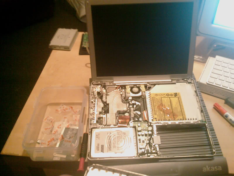

taking out the 2 connectors on the logic board is tricky they are extremely fragile and will break if you are not careful - almost done!
then finally, removing the harddrive. taking apart the caddy and literally swapping the drive over and following the instructions (www.ifixit.com) in reverse!

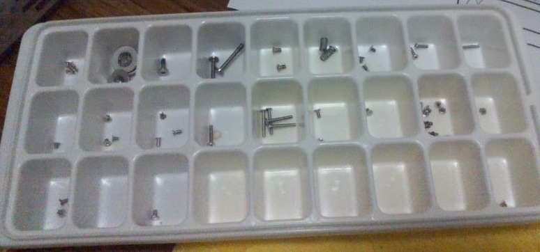

there is 50 screws total! you dont need to take them all out to swap the hdd but i will have to take a load out to swap the bottom case :S
Did you label all the screws, cause I think I'll have to do that.
i did, i used tape to hold the screws togther and labelled them with 1. the part they came from (e.g. batt compartent) 2. the step it is (1 - 16 corresponding to the ifixit step) and 3. the number of screws that should be in the tape package. its the best way, they are so easy to lose, make SURE you dont loose the emi finger!! (will fry your ram!)

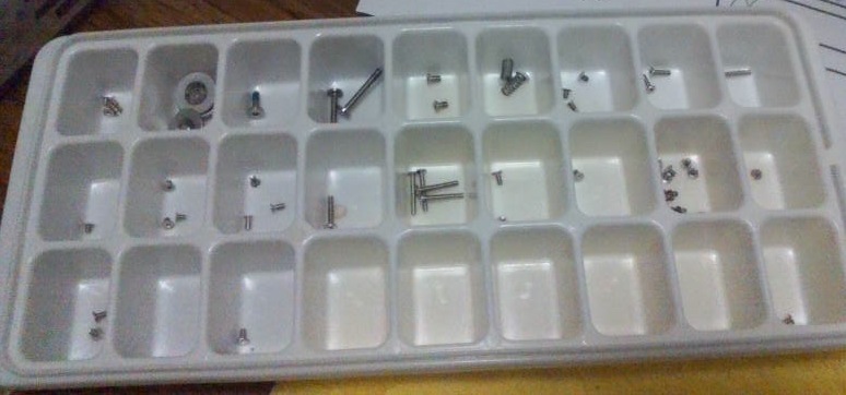

an ibook g4 is definitely an adventure, took me around 90 minutes and a lot of stress. I think apple decided to place all the excess screws they had into the ibook g4, because there has to be at least 10 different types
How on earth did you manage to do it in an an hour and a half!😱
Took me that time just to get the damn hard disk out, and another 2-3 to get it all back together again (plus another hour the next day when I realized I had a screw in the wrong hole!)
You are right about the screws..I think there was about 35 of them, and about 30 of them were different.. pain in the ...
Wish I had put a 250gig in now, as I'm not going to do it again. But you live and learn, I have no fears about doing any other mac now. Definitely an adventure!
