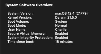

Running MacOS 12 Monterey is not an issue for Early 2015 MacBook Airs as I am running this OS on mine without any issue. The fan rarely goes on. I'm running System Firmware Version: 430.120.6.0.0 and System Version: macOS 12.3.1 (21E258) which is the latest release.
I noticed in the post above whether or not this is an appropriate software for the Early 2015 Air. I can say from my experience it should not be a problem as I have not been experiencing any performance lags or kernel panics or any other issue since upgrading from Big Sur Mac OS 11. I would suggest updating the the most current firmware, perform a PRAM reset then allow the computer to fully boot up to see if that clears your issue.
12.4 is the current release, not 12.3.1, for what that's worth, although 12.4 doesn't contain a firmware update for these computers over what's in 12.3.1.
I just updated to macOS 12.4 (21F79). When I posted earlier I was getting no notification that there was an update available for my laptop until after I had posted my earlier comment.
