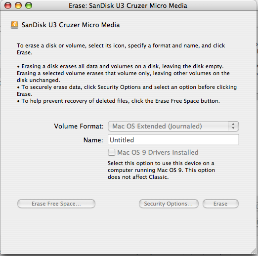

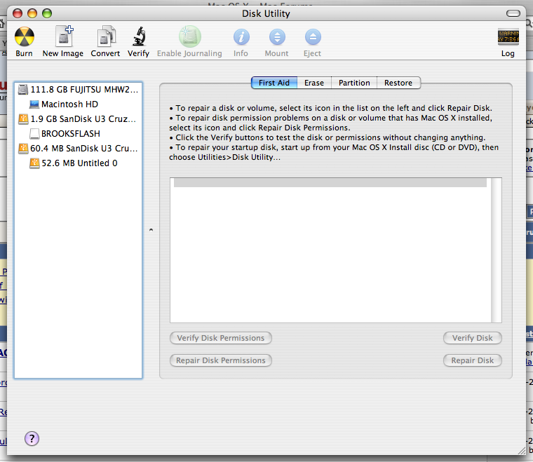

Here is what I end up with. It looks completely inaccessable. I don't really see how software can make it self virtually unremovable on something like a flash drive. I'd think that you'd be able to completely format it without the software being able to stop you :/
It's like the flash drive itself is partitioned to have both the rewrite-able flash and the unwritable U3 software garbage.

Are you sure you've selected that drive and not that volume on the drive (sorry if I'm not using the right terms here)? For instance, is there a USB drive icon right above the SanDisk U3 flash drive USB drive icon? If so, try erasing it there. If that doesn't work, try deleting the partitions and re-creating them.

I just added another picture, what I'm trying to format is the actual U3 drive, not the 1.9gb.
it seems that the only way to remove it is to put it in a windows machine and uninstall the software...
read here for more information, it seems that that was the conclusion.
http://forums.macosxhints.com/archive/index.php/t-63205.html
Looks like it. Oh well, I'll just download some more of that nifty U3 uninstall software and put it on the drive itself and then remove this garbage once I get to another windoze computer.
