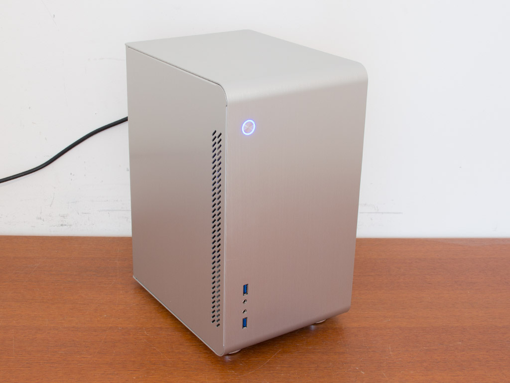

So, it was long wait. Had a lot of time on my hands to think about an alternative for a disappointing Mini. I'll leave it here should anybody be interested. Keep in mind it's admittedly over the top and makes no compromises to achieve silence and low temperatures (as any Mini alternative should).
1) Case: Jonsbo U3 / Rosewill Legacy U3 / Cooltek U3 (~100$)
Why: one of the smallest mATX (= 32gb ram possible, compared to mITX which is limited to 16gb) case, apple-like all-aluminum design; one of the few SFF case that can accomodate a long PSU.
2) CPU: i7-4785T (~400$ on ebay. OEM part, hard to find)
Why: at 35W, coolest i7 desktop haswell 4C/8T
3) Mobo: Asus Maximus VII Gene (~220$)
Why: bells and whistles (wifi AC, bt 4.0, audio section, etc.), quality, software
4) RAM: 32GB Crucial BLT4C8G3D1608ET3LX0 (~340$)
Why: low profile for clearance flexibility while building, 1.35v at cool 1600Hz, good timings (cl8), 32GB (instead of more reasonable 16GB) "because I can" (compared to the Mini).
5) PSU: Corsair AX1500i (~450$)
Why: ok, this is going to be highly controversial. A 450$ psu in this kind of SFF low power build? Madness! Still: 1) QUALITY 2) Fanless operation up to a threshold that this system will never hit = virtually fanless. We're going for Mini-grade silence.
6) GPU: ASUS STRIX-GTX750TI-OC-2GD5 (~160$)
Why: fanless operation up to 65°C = it will be silent during light to medium destkop load; 750ti because it has stunning performance per watt at 65W; does circles around the integrated intel HD4600.
7) SSD: Crucial CT1024M550SSD1 (~470$)
Why: capacitors for power loss protection while the second bit in the MLC cell is written = no risk of corrupting stored data; fast enough; 1TB (instead of more sensible 512GB) again "because I can" (= relatively cheap compared to apple own upgrades).
8) HDD storage: as many Seagate STDR2000100 as needed (~120$ each)
Why: the STDR2000100 is an external 2.5" drive, you have to crack it open (super easy, provided you're ok with destroying the outer shell and discarding it) and you'll get the slimmest 2TB hdd possible (9.5mm), buying it already naked costs MORE (go figure). You can prop a number of 2.5" 2TB drives inside the case, officially up to 4 (via Silverstone SDP08B adapters in the two 3.5" bays) beside the 2.5" SSD (for a total of five 2.5-inchers), you could also use a m.2 ssd as the boot drive (like Crucial CT512M550SSD4 at ~280$ for 512gb) and free a 2.5" bay for another hdd. So where at one 512GB M.2 ssd stick and five 2TB 2.5-inchers, there are still 3 free SATA ports on the motherboard. Enter industrial strength velcro and ps3 metal caddies (to avoid ghetto-glueing the velcro directly on the HDDs), find a way to strap them to the walls of the case and we're at eight 2.5-inchers. Then it's up to you....RAID10, RAID6, etc..
Of course this is the most extreme configuration. If you just need 1-2 drives try not to populate the bottom of the case at all, since it's the main air intake.
9) Rear case exhaust fan: Noctua NF-S12A PWM or FLX version (~20$)
Why: optimized for silence; choose the PWM version if you want to set up the temp/rpm curve in the UEFI/asus_software, pick the FLX version if you're ok with it working at a fixed speed using the provided low noise voltage adapters (and hence not worry about the software control misbehaving). Even at a fixed 700rpm the FLX one should be very silent. Remember to set it up as an exhaust (company logo facing the outside of the case).
10) CPU Cooler: Noctua NH-U12S (~70$)
Why: silent, slim design, 1 or 2 fans config possible (probably 1 is enough). With that kind of cool CPU (35W tpd) the heatpipes alone can probably dissipate most of the heat during light workload. Comes with Noctua branded thermal paste. Mount the fans in line with the rear exhaust fan. The fans are PWM controlled, using Asus AIsuite you can set the temp/rpm curve in order to make them start only if the CPU reaches like 60°C, basically only under medium-heavy load. Notice how were going for silence in a SEMI-passive fashion. But it's going to behave like a passive system a lot of the time.
11) OS: Windows 8.1 Home full RETAIL reinstallable license (~100$)
Why: Good bang for the buck. Pro is mostly useless for home users.
12) Software for playing movies: MPC-HC (Free)
Why: it smokes anything available on OSX. Even in its "vanilla" "just installed" status (no tinkering with settings and externals filters), it's plays perfectly, with pristine quality and responsiveness 1080p of any bitrate, BD/DVD disc images (mounted as virtual drives), BD/DVD folders (it integrates in the Windows rightclick contextual menu...try that on OSX...no player "just works" by rightclicking on the folder, since there's not "Open with..." for folders...you are forced to convert everything to MKV with MakeMKV), all of this by leveraging mostly the GPU via microsoft DVXA. (or other ways if you're willing to tinker). Then with time you can discover madVR renderer, upscaling of DVDs and the like.
