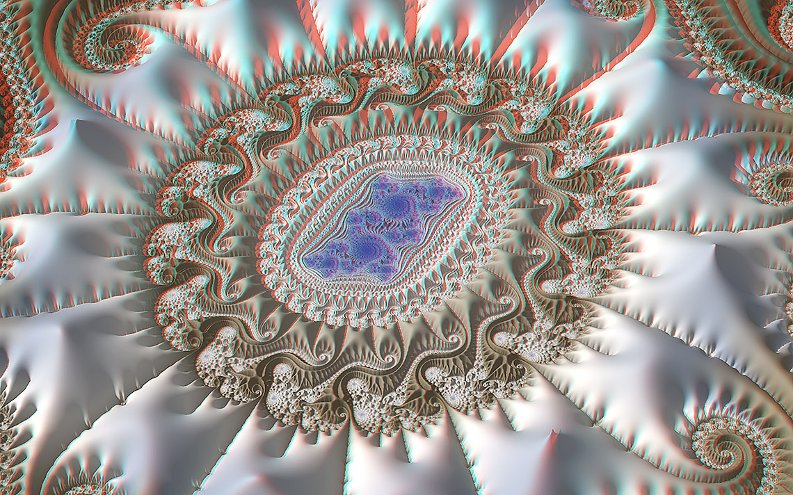

Our company's app, FractalWorks (For mac) does stereo projections of 3D fractal images. One of the output methods is as a color anaglyph.
I was the developer. I used OpenGL (desktop version) and perspective projections.
I found articles on stereo projection online. Here is a current version of one of the more useful links I found:
Calculating Stereo pairs
OpenGL includes the ability to render images into stereo frame buffers. To create an anaglyph, the simple way is to only capture the red channel for the left eye, and only the green and blue channels for the right eye.
I don't know about patent issues. As the other poster said, there are lots of absurd software patents out there.
The effect can be quite good:
