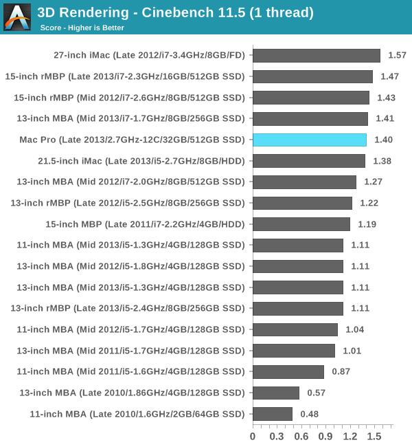

“The 4, 6 and 8 core CPU options all offer the same peak single core frequency (3.9GHz). This is very important as single threaded performance remains the gate for system responsiveness outside of thread heavy applications. The 12-core CPU sacrifices around 10% of this peak single core performance.”

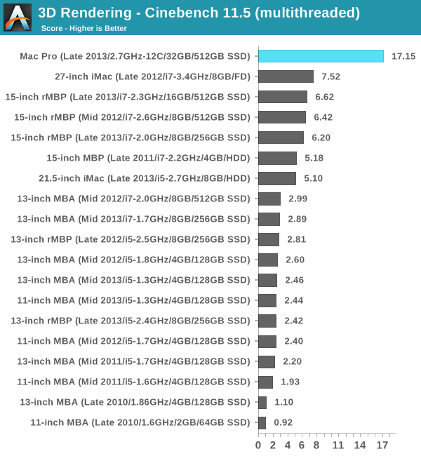

“There is a very healthy increase in single threaded performance over the 2010/2012 12-core system. The 34% increase in performance is because the Mac Pro never got the Sandy Bridge bump. All previous Mac Pros topped out at Nehalem/Westmere. Couple all of the Sandy Bridge improvements with the much higher peak clock speeds (3.5GHz vs. 3.0GHz) and the performance gains make sense.

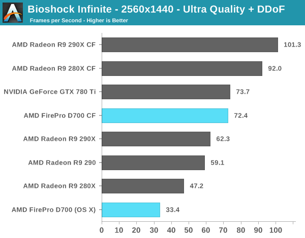

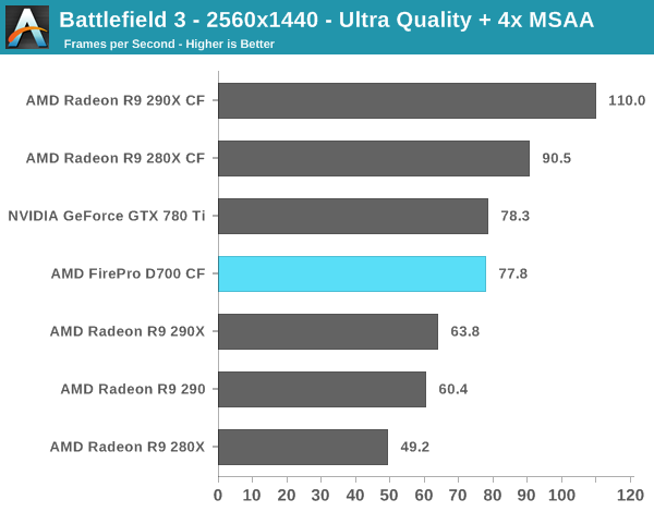

“Under OS X games have to specifically be written to use both GPUs in the new Mac Pro. Under Windows however it's just a matter of enabling CrossFire X…. CrossFire is clearly working under Windows”

It's interesting to see that the Mac Pro does have CrossFire support in Windows, though applications in OS X will only use one GPU unless explicitly coded for using both.
Performance is not where it should be though. A single GTX 780 Ti is putting out higher framerates than the dual D700 Mac Pro in games.

It's great that crossfire is working on Windows. It should put everyone's worries to rest whether or not they could game with this machine. And on OS X it'll perform slightly worse than a single 280X, which is still quite decent gaming performance.
What I wonder is whether game developers can actually support dual GPU's under OS X via some later to be released API by Apple.
