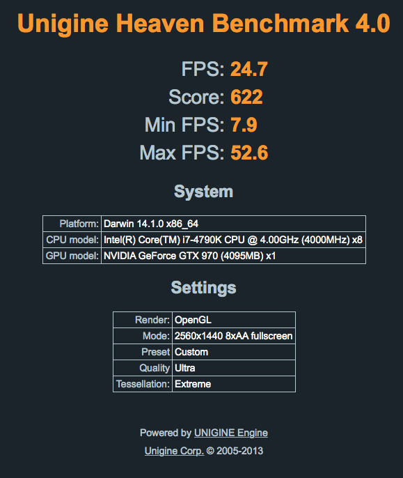

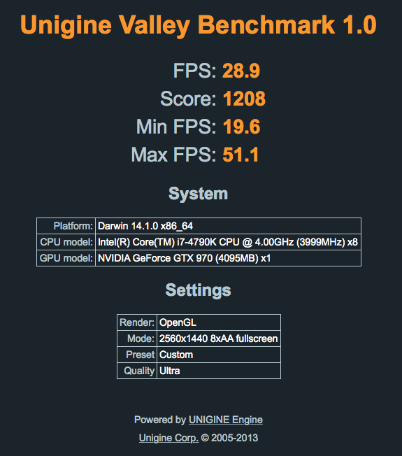

Maybe the attached shots can help, mind you, it was using a Hack, and at maximum settings at 1440p.

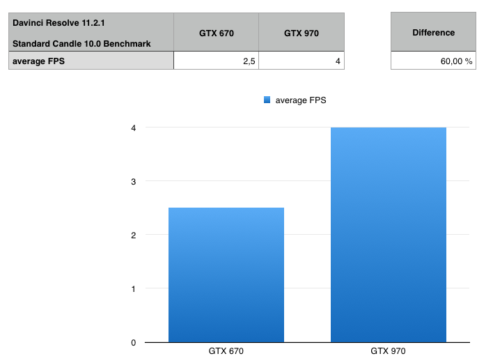

Also added a DaVinci Resolve benchmark result for that Standard Candle 10 benchmark.

Thanks @Gwendolini for those uploads.
Are you using the full DaVinci? I've tried to run that Standard Candle test a couple of times, but it just won't import/load with my DaVinci Lite (tried a couple of different versions).

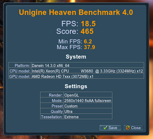

I'll do some benchmarks at your resolution with my 280X. I think it's around 18-19 fps on my 3.33Gz 6-core Westmere.
The gfx card will be the greatest influence of the score of course, but I think you're probably getting a boost for that 4GHz CPU too.

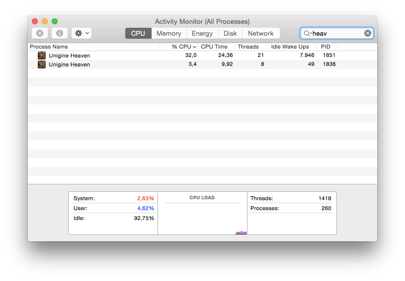

As for Heaven and CPU see attachment.

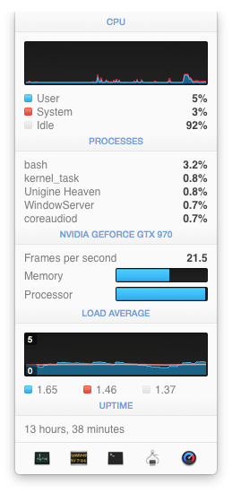

It does not seem possible to edit a post and add another attachment, thus here another one from Activity Monitor.
This image can't possibly be a representative average.
I'm open to the idea that modern game design rely much more on the GPU than when I looked at game benchmarks (probably 8 years+ ago), but almost zero usage makes no sense. You second grab with around 30% still surprises me, but OK, that's cool.
There might also be a difference between playing an actual game and reading a relatively short benchmark into memory? Anyway, that doesn't matter when looking at gfx card performance. It's perfect that it doesn't rely too much on CPU.
That is 30% out of 800 %, thus 3.75 % CPU usage.
It is a GPU benchmark after all.
