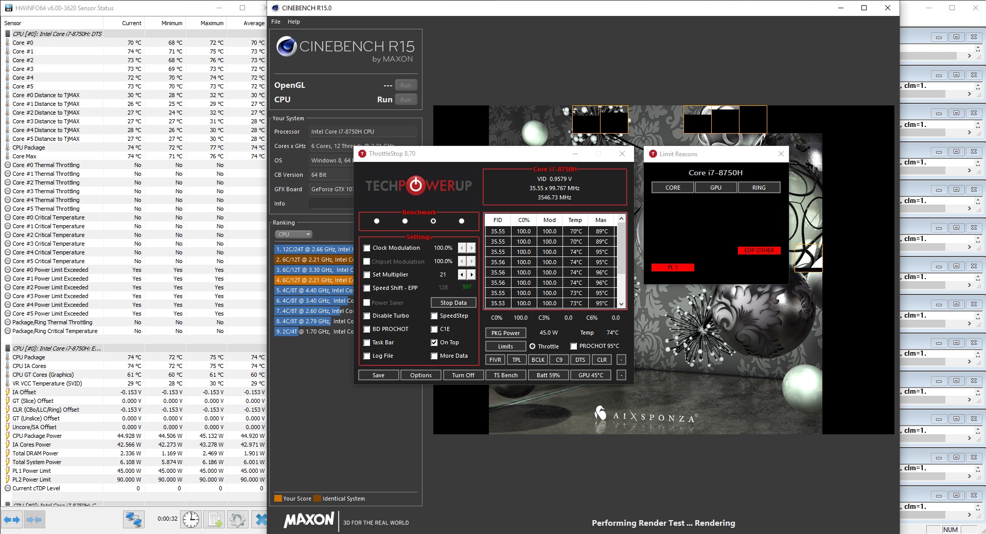

Cinebench R15
Would like to see it pass 1280CB on stock W10 Pro

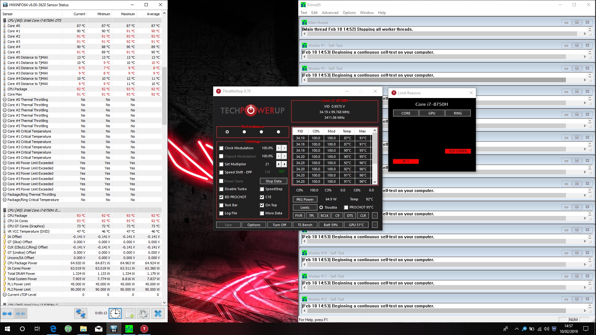

Max performance, CPU PL-1 set at 65W
System is flagging throttle due to hitting the enforced 65W power limit (default 45W). I can increase far more, however it will then be limited thermally, well if you call this level of performance in a notebook limited 😛 FWIW the 8750H pulls around 86W at full tilt, MBP need not apply 😛
No we're getting silly Prime95 & Cinebench R15 running together CPU in the mid 70's and the GL703GS still scored over 1100CB 😛
But how? On mine, with -140mV, it hovers around 65W at 3.9GHz. There are no power limits anymore, I have no more throttling indicators in Throttlestep. I can't go any higher without getting the 2.6 or i9, that's the max turbo on all cores for 8750H, this thing is now clock limited. But I've seen with my own eyes the 8750H pulling 80W I just can't replicate it now without power limits, it is almost like it was forgetting clock limits for short bursts.
Via ThrottleStop by raising the PL-1 power limit, although if your hitting 3.9GHz there's no point as it wont go any higher. Prime95 Small FFT will kick up the CPU seen it passing 85W.

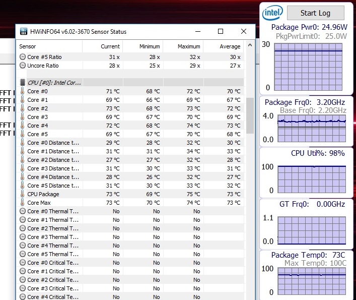

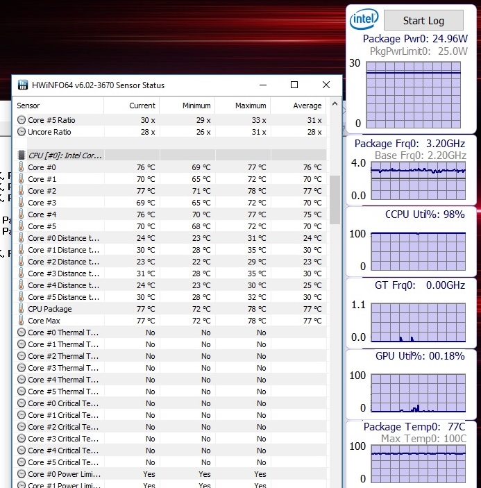

Looks like dual channel RAM has large effect on this benchmark, with single stick I was getting almost 3 minutes and 2700k rays/s. The best Cinebench is now 1261 and I have no idea how that can be improved any more.
The repaste improved CPU somewhat, like a 4-5 degrees, but it also reduced the spread between the cores. Before you can see even and odd cores being way off. That's while running small FFT in primes.
Before:
After:
Don't pay attention to 25W - the reported package power is offset by 32W so in reality that's about 57W, Dragon Center disables the power limit adjustment in Throttlestop - it was still getting down to 45W, offsetting the reported power was the only way to prevent power throttling. But I didn't want to go all the way in because this causes oscillation (at like 65W or so) making it hard to compare results and at 45W only it was too cold (tell that to MBP owners). The Corona is made with about 77W power limit but it just maxes out at 3.9 GHz.
On the GPU side I should have used more TIM, my temps went up by 2C (I had 60C and now 62C after three runs) - although the Valley score went up 6% for some reason, wondering if the dual channel has something to do with it to and can explain the increased temp. I just don't feel like opening this up again, but I'll probably do anyway, it is not that hard. You have to use a lot of TIM, more than seems reasonable, but I'll wait until next week, some report that Kryonaout has some cure time. All those tests were made immediately after putting all back together, fans forced to max.
