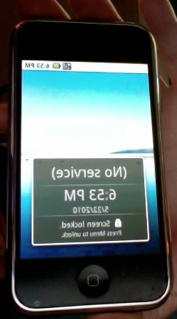

I was so excited when I found out that I can install Android on my (only) iPhone (it is a 1st gen). After a couple hours of work, I installed it on my aging iPhone. I am able to dual boot it between iPhone OS and Android 1.6. My issues lie in the Android side of things. On Android, I am unable to get on AT&T's cellular network. It recognizes the contacts from my SIM card, and it can recognize my cell phone number, but it cannot connect to AT&T's cellular network. It greets me with no bars and a message on the lock screen that simply says "No Service." When I boot back into iPhone OS, I get full bars of service and Edge, and full bars of WiFi.
Is this an issue with APN settings? If so, can anybody give me the correct APN settings for AT&T?
It is also difficult to connect to WiFi with Android on my iPhone 2G, but that is not such a big issue.

do you think this is more impressive now that i tell you that i am only 14? by the way, a picture of my issue is attached.
sorry that it is reversed. i took the picture with my isight, and i forgot to reverse it, to look normal.

Add a new APN under Settings/Wireless & Networks/Mobile Networks:
APN: wap.cingular
Proxy: leave blank
Port: leave blank
Username:WAP@CINGULARGPRS.COM
Password:CINGULAR1
Server: leave blank
MMSC: http://mmsc.cingular.com
MMS Proxy: wireless.cingular.com
MMS Port: 80
MCC:310
MNC:410
APN Type: leave blank

Really? Really? it seems like you only came here for attention from that comment and the reason it wont work is that the 0.1 build doesnt really support carriers it can sometimes get signal but not consistantly enough

Exactly. It's still on early stages.
You can use skype and other voip apps though.
