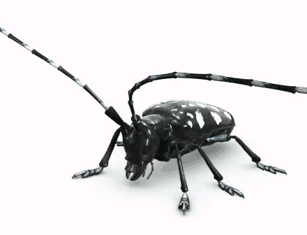

There is an animated GIF of an Asian Longhorned Beetle. I think someone from the USDA made it, but I can't track down who.
There are a lot of other invasive species I would love to see animated in a similar fashion for educational use, but I have no idea where to start, what applications would be needed, or how hard this would be. Any ideas where to start? There's a fair amount of video out there of several invasives like spotted lanternfly that could be used for reference.

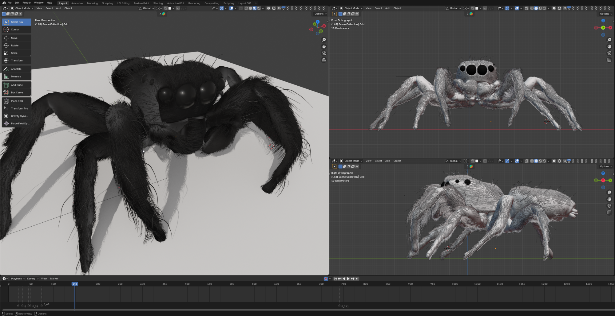

You have two options:
[1] animate with a 3d model (this is what your posted example is made with
[2] use generative AI and hope for the best
[1] means either (a) modeling and rigging your own insect models or (b) acquire these either for free or for a fee from various 3d model repositories. Then animate these.
(a) is time-consuming and requires a lot of artistic and 3d modeling/rigging knowledge and experience. It will take someone with zero experience a year or so to achieve acceptable results such as in your example. An alternative for modeling would be to scan actual insects. But for smaller species it means quite specialist equipment or at the very least magnification.
(b) is quite doable, but you will still often need to rig the models, since rigging (virtual bones to animate with) is not always part of a 3d model (not even commercial ones).
Examples of free models are:
The quality will differ, depending.
Other resources are academic endeavours which are building repositories of 3d scanned animals.
Most academic sources use Blender (which happens to be entirely free and open source!)
I loaded the jumping spider in Blender:
But this would still need to be rigged before it can be properly animated. It's not too difficult with autoriggers, though.
Still takes time and learning. Then animate according to reference materials, and render to an animation.
[2] is, as @wonderings demonstrated, also an option. The problem is always accuracy. Details almost always go wrong, and it is generally quite plain that it was AI generated.
