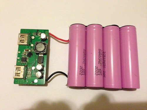

Most portable chargers in the market as of now use type 18650 Lithium-Ion. They are proven safe, compact and cheap to produce and are basically the same as the one in your phone, just rolled into cylindrical shape. So have you wondered, why do manufacturers rate their power packs with such strange capacities, e.g. 2600, 5600, 10400, 15600mah? This is because 18650 batteries comes in standard capacities, and they go from 1,200 to up to 3,400mah, with 200mah steps. Their price increments gradually as the capacity increases, and they can vary A LOT depending on the quality of the cells. In a 10400 rated pack, the manufacturer uses (or wants you to think it does) 4x 2600mah cells. But even when you pop it open, there is no exact way to visually identify the capacity of said battery, if there is no spec on it:
This is a chinese power bank with 4x parallel connected generic 18650 cells in it, they are probably rated 2,400 but actual capacity could be as low as 1,400mAh. Avoid them.
But there are times where genuine branded batteries are used, like this samsung 18650 cell, rated 2,600mAh, which I was very happy to find inside the RavPower 10400mAh:
