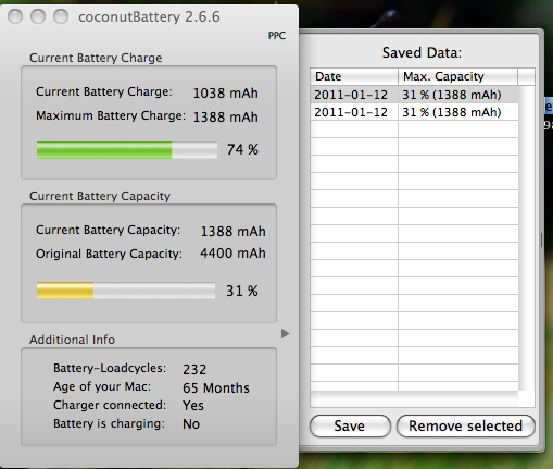

Hi Msjones
It seems you are right The bat is loading but not fully anymore have a look
thanks for the help(-:
P.S will i partially improve the battery with letting it go down or should i keep it always on the charger????
232 load cycles for 65 months is pretty impressive. I'm not sure there is much you can do to resolve your problem. If you intend on keeping the iBook you could invest in a new bettery. You can pick these up from ebay. I got one for a friend a few months back and that came to about £35 in the UK.
