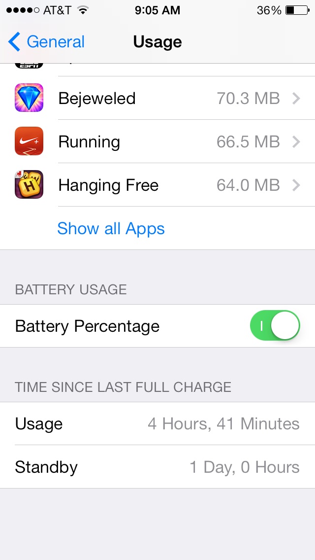

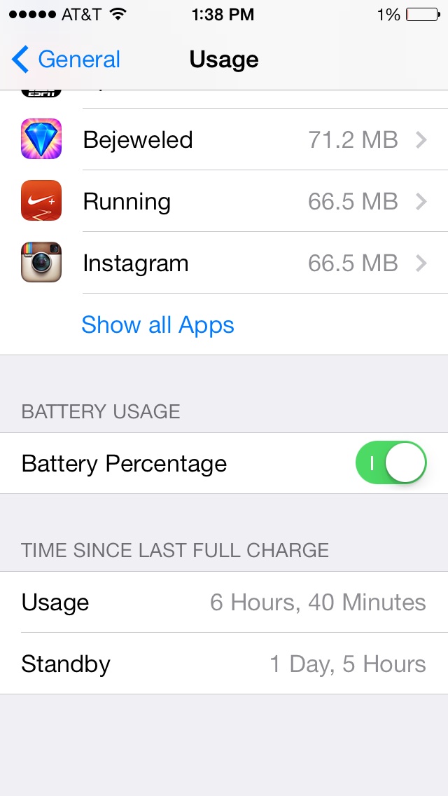

Almost the exact same. My iphone 5 is from December last year. Ios 6.1 was fine. I was jailbroken since February and things were fine. I would get 6-8 hours on wifi with regular use like web browsing, Facebook, tweetbot. Just light usage things. I decided to take the plunge with ios 7 and now I'm barely getting 5 hours usage with the same usage patterns. And yes today I've noticed my battery will drop in about 8% chunks when the battery is getting in the lower range. Its got to be a software related problem with the battery algorithm. I restored and started as new. And also have calibrated the battery and it still happens. Hopefully 7.1 is better! Why did I lose my jailbreak for this?!?
I noticed my big 8% chunk drops happened when I left the house and was on lte and my brightness went to full blast. I was at like 28% then it went to 18% then down to 7%. Now that I'm back home (back on wifi with probably 35% brightness) it's just been sitting at 7% for a long time. So this tells me the battery algorithm must be wacky. And remember I have calibrated my battery by running it down and charging to full a few times so it isn't that. I had a battery app that showed me that I had 395 cycles on my battery. But it was still holding nearly 1340mAH of power and I was still getting great battery life then on my jailbroken ios 6.1. The ios 7 is just sucking the battery more no doubt about it. Maybe that's why they increased battery capacities in the 5c and 5s to compensate. Us iphone 5 owners will probably have to just live with 1-2 hours less usage I guess. It sucks!

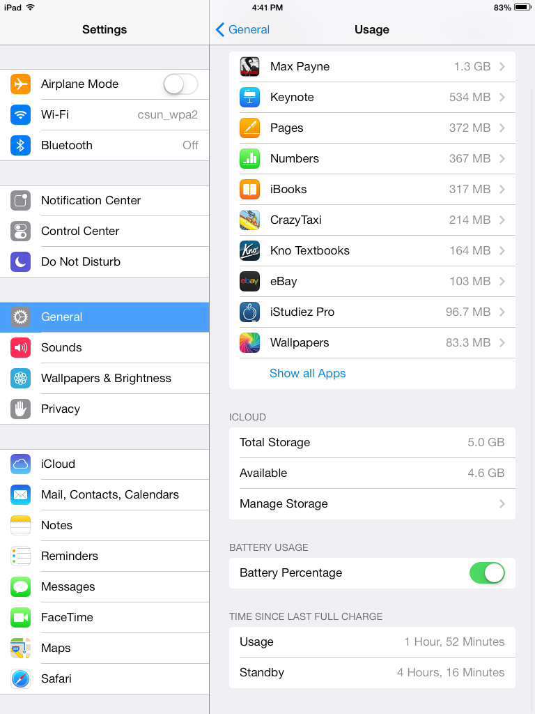

I don't know if it's just me but for some reason, starting this week, on my iphone 5 and ipad air, I've been losing a lot of battery and not getting anywhere close to what I used to get say a month ago. Right now I'm on my ipad air, I charged it to 100% and I'm down to 96% after 29 minute usage and 1 hour 4 minutes standby. It seems like it just isn't lasting as long. Is this an iOS 7 problem?
same here, I barely used the phone yesterday...left the house around noon and came back around 2 and I had barely any juice...I closed a lot of the background running stuff and plugged the phone in....left the house again @6p and the phone was at halfway by 9p and I wasn't on the phone cause I was in the pool swimming. thank goodness i have a mophie juice pack because this is crazy. hopefully 7.1 will be better.

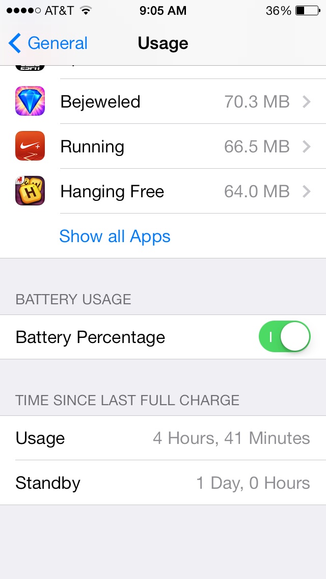

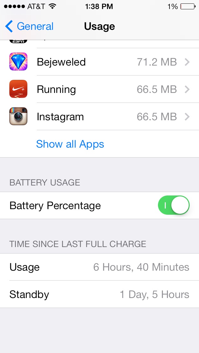

Here's my stats in the pic below. The percentage meter has been going done mostly like it used to but maybe a little faster at first then before. I'll report back if I start getting the big chunk drops which seemed to occur around this time and below 30%. I'm getting 1-2 hours less usage from ios 7 but at least my meter isn't as screwed up anymore.

So far so good! The battery percentage meter seems to be working like it used too again! Got a pretty typical battery result for usage and I watched the meter drop down without making big jumps. 🙂
