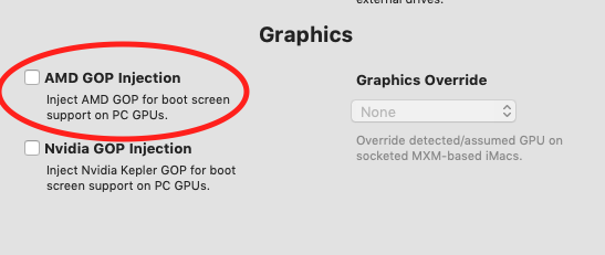

I have tried toggling the option in OCLP for AMD GOP insertion. There is no change in behavior whether that setting is on or off. I have tried resetting parameter RAM. I have tried installing OpenCore onto one of my internal boot disks rather than the USB installation drive. None of this has made any difference.

Thanks for the reply -- I'll look into that. But isn't that issue what this setting in OCLP is for?
OCLP defaulted to leaving this unchecked, which made me think my RX 560 didn't need it. (Everything else that's required for this system seems to have been selected.) But it didn't work, so I tried checking that box and then reinstalled open core. Again, nothing. I'm fine with investigating the EnableGOP EFI module you linked to, but it seems like that checkbox in OCLP 2.4.1 should cover the issue already. Or is there some subtle distinction I'm missing?
No, this won't work with Mac Pros. This is a complicated topic and I'll greatly simply.
MacPro4,1/5,1 default graphics protocol is a flavor of GOP that was developed by Apple years before UEFI GOP was ratified as a standard by UEFI Consortium and Microsoft. Almost the same, but incompatible.
The GPU needs to be initialized by the Mac Pro firmware at POST or OC/OCLP won't have a working display - the option of OCLP to inject GOP is to make some stubborn compatible card to behave correctly (usually for MacPro3,1 and iMacs), but won't make an incompatible card at pre-boot to work.
The only way to have display working at pre-boot for OC/OCLP to work is one of the options below:
  • having an AppleOEM GPU,
  • having a PC GPU flashed to Mac Pro pre-boot display compatibility, like MacVidCards or older self-flashed GPUs,
  • having the combo of EnableGop injected to the Mac Pro BootROM plus UEFI PC GPU with the factory firmware unmodified (there are reasons for that, like for example the Mac Pro BootROM rejecting to load any GPU firmware that was modified and have invalid cryptographic signing of the firmware).
For you, the last option is the one that is gonna work.

Thanks again for the quick reply. I'm concerned about the warning here -- I'm fairly sure when I bought this GPU on eBay that the listing said (or strongly implied) the firmware was updated -- "Modified to work with OS X 10.14 Mojave" or something like that. Which would mean that the factory firmware was modified. But I have no way of checking that listing years later.

The first two requirements make sense. It's that third one that has me a little confused. I can't tell if my GPU will produce graphics when using OpenCore, because I don't have OpenCore working yet. How will I know if this card meets that requirement before I've gotten it going?
From what you wrote on the first post, your GPU have a display working ONLY AFTER macOS loads the GPU driver in the final part of the loading process and no OCLP BootPicker at all.
So, you'll need EnableGop injected to the BootROM and to make sure that you have a factory unmodified GPU firmware - since you could have a messed-up mining or gaming GPU. Read more about it here, there are a lot of info applicable to you in the posts near mine, read it all:
Run Windows, dump your GPU firmware with GPU-Z and verify the checksum of the firmware with TechPowerUp dumps of your exact GPU.
This is the post that you gonna need if the GPU firmware is really modified and you need to go back to the factory GPU firmware:
