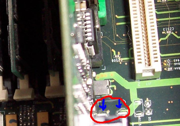

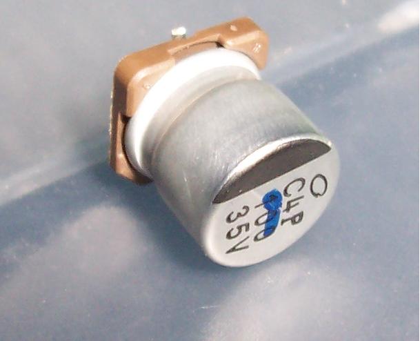

Well I tried to mess around with it today .. to get the AGP slot working, I took the Geforce2 out... put it back in as tightly as i could. I powered the G4 up to see that it is now giving a signal through the VGA port. The picture was just whitevertical lines about a pixel apart on the most right part of my 17" CRT I was testing with, as the G4 was booting I could see some of the pixels changing colors.. etc. I found a POS ATI Xclaim macintosh PCI video card I booted the machine with. OS X tiger did not have drivers for the card, so it ran in just 256 Color with the PCI card... I was able to open up system profiler and see that the Nvidia Geforce2 card is listed just fine, but wont quite work properly. I shut down to try the other card again. As I was removing the pci video card I seen a capacitor ( at least i think thats what it is, barely hanging on, on the logic board that is right next to the AGP slot, right next to the I/O panel of the back of the G4. I touched it and it came right off, Just to make sure I powered up the machine again and it booted fine, but with the same video problems. I was thinking about it, and could probably solder this piece back onto the board. Is there any experts out there anywhere that know for sure that this may fix my problems I am having? Thanks.. I will post some pictures.

Years of troubleshooting and soldering under the hood here. Are you sure that cap is from the Mac's logic board, and didn't fall off the fried AGP card instead? Anything can be resoldered if the trace and pads aren't skrewed on the PCB. I would be willing to perform the operation for you for $5 (to cover gas and materials) + return shipping if that's all that's wrong, but couldn't guarantee that it is the cause of the video problem.. I don't think that it is because a 35V cap doesn't seem likely to be on any of the VGA lines.. then again, if its being used to smooth choppy power, it could be the fix.. Can you double check the video cards for missing caps? Generally, if anything's gonna "pop" "sizzle" or "bang", it's a capacitor first..
(Send me the highest detail pictures you can take of your main board and the offending AGP video card that caused the trouble so I can look for any visually recognizable problems).. fixm(-remove4emailantispammeasure-)@adelphia.net

Well I'm very sure the piece came off in the picture where I pointed it out, because I can see the broken solder point... but the thing is, I dont know exactly which way it goes on, does anyone out here have a Digital Audio computer and would like to take a high resolution picture of their PCI/AGP slot area for me? that would be nice 🙂 thanks...
