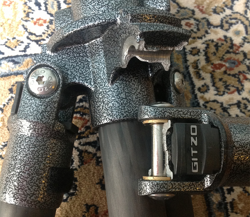

Some of you may remember my thread from two years ago about the material failure (and warranty repair troubles) that I experienced with my first Gitzo tripod. Just last night I had a second one fail in a similar way, this time a 2-Series carbon fiber model:
And I came across a thread on another forum with several other people reporting precisely this failure with the same model (GT-2531): http://www.latogaphoto.com/2009/12/photo-broke-gitzo-tripod/
I had a 5D Mark III with a 17-40 f/4L mounted on it, so it was nowhere near to being overloaded. Like the other people in that thread, I was using it in the cold (-11 C) and simply pushed down on it a bit as I always do to ensure that it was stable--something one ought to be able to do with a tripod. I always carry it in a padded bag and am very gentle with my equipment. I did absolutely nothing in the least bit abusive to it.
I'm now wondering if maybe I should switch brands. I'm not sure I can trust Gitzo anymore so long as they are using this apparently fragile alloy to hold the legs together. I paid good money for Gitzo tripods because I wanted equipment that would not let me down.
Should I be considering a switch to RRS? It looks like they don't quite have a comparable set of legs (something that stands as tall and is just as light). Has anyone had any problems with a RRS tripod? Any other suggestions for me?

Yes, I did get lucky. It didn't fall, probably because the snow was keeping the legs from slipping away. I was wearing snowshoes at the time, so if it did fall spectacularly, I wouldn't have been very nimble about catching it. I actually have a photo of me shooting when the tripod broke. I'll share it here just for kicks...
Bleh stupid cast collar pieces😡. I'm not sure what I'd suggest in tripods today. Manfrotto is under the same ownership. I tried the RRS pano head prior to the addition of the really heavy one they label as a Gimbal. I needed something to help make spherical hdris. It was nicely machined, but the puny locks could not properly support a 1DS. It was just irritating that when I told them what I owned, they didn't mention that it might be too much for the kit. The other problem I had with it was the L bracket had a little bit of flex, which only really bothered me as I needed to stitch images. I haven't tried anything from them since. The quality of the overall kit seemed good. It just wasn't designed for heavier cameras. I haven't tried any of their legsets or ball heads.

Yeah, I think the cold weather has a lot to do with it. Both of the times that I had a Gitzo fail like this, I was shooting in very cold weather. The other people reporting the same problem in that thread I linked to above likewise were shooting in low temps.
I will definitely report back about the warranty experience on this one. My situation is very complicated because I split my time between two continents. I purchased the tripod in the US, but at the moment I'm in Europe, where the warranty is no good. So I either have to get the tripod to Bogen/Manfrotto in New Jersey for repairs or else I have to pay to have it serviced here in Europe. Either way, I'm probably going to be without it for at least a month, especially with the holidays coming up. And of course I have a big photo trip coming up soon...Murphy's Law at its best... 🙁

Many thanks for the info, jabbott. Yes, I'll definitely get the Gitzo repaired under warranty. If I could get it immediately, I'd probably just go on using it, but it took them well over a month last time to get my repair done. If I do replace it with something else, then I'll either keep the Gitzo as back-up or will sell it. It will go in for warranty repair, though.

Well, the tripod didn't even fall in the snow. I was standing there checking whether or not it was stable when I heard a "CRACK!". It worried me, but even then the tripod didn't fall (I think because the snow helped it to stay up), so I kept on with my work. It wasn't until I went to move the tripod that I realized that it had become a duo-pod. 🙁
Your advice about shopping is definitely good, but how would anyone looking at a Gitzo in a store come to the conclusion that it would fail as mine did? A guy on POTN told me that a sales rep in his local store put all of his weight on a standing Gitzo just to show how sturdy it was.
Anyway, I do expect that Gitzo will honor my warranty, though one person in the thread I referenced earlier was denied. Assuming they fix it, I'll then have a tripod that I can't trust. That is a problem.

Many thanks for the link, Dale. Alas, the part that broke on my tripod is also present on his. It's the top "spider" of the unit that holds the legs in place, which is made of a cast alloy. The idea of having a machined metal instead of the cast metal is very appealing to me at this point.

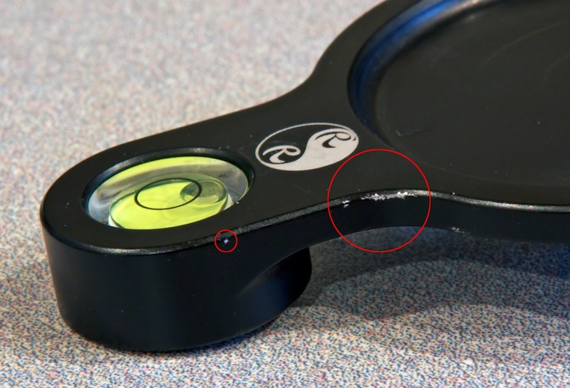

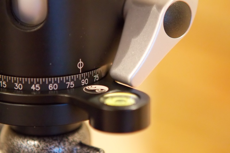

Edit: Could you elaborate on the "chipping" of the RRS item you purchased? Was this a cosmetic or functional problem? Either way, your description of their customer service is very worrisome.
It was a cosmetic problem that arose out of having the BH-40 ballhead release lever set in the factory position. One of the features of their ballhead is that you can pull the release lever out partially and rotate it 60˚ into one of six different positions. My ballhead shipped in a position that readily interferes with the bubble level, and I didn't even know about the lever rotation feature until my bubble level was damaged from rubbing between the two items and I contacted RRS about it. If the lever had shipped rotated one position higher, there would have been no damage at all to the bubble level because they wouldn't have interfered. This photo shows the interference between the two pieces:
The resulting damage to the bubble level:
After this issue, I realized another issue when using their bubble level - it prevents free rotation of the LR clamp:
I've since stopped using the bubble level altogether, as it just wasn't worth the hassle. Thankfully the 5D3 has a nice built-in level. Since contacting RRS about the bubble level, my ballhead has also developed chipping similar to the bubble level, despite treating the ballhead very carefully. It still lets me take stabilized photos though, and that's really what matters. 🙂
