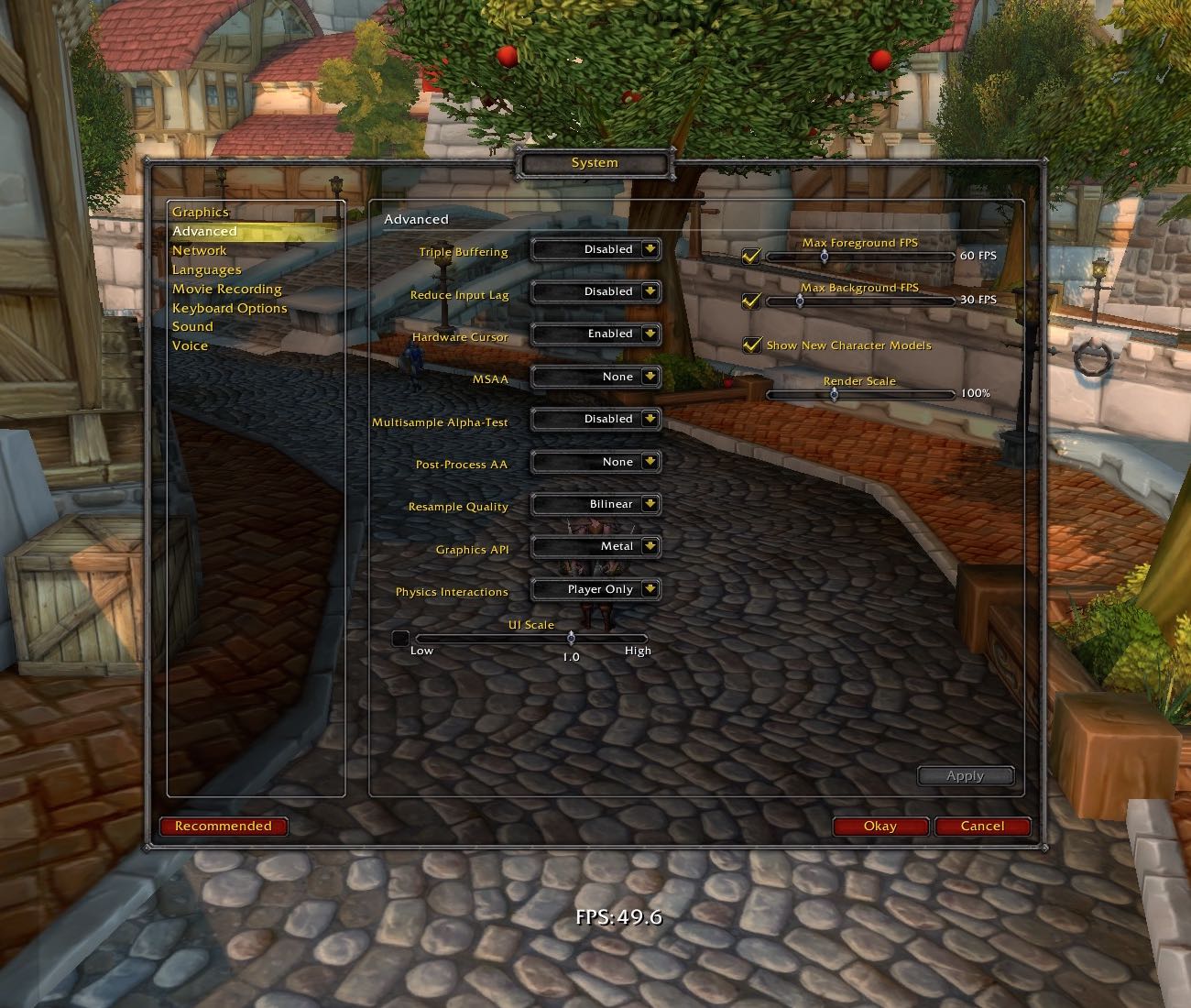

I am using Metal.
The the OGL 3.2 renderer in Legion is using a shader model 4 render path, whereas Metal is running a hybrid of SM4 and 5. The Iris is a SM4 card, so the way sunshafts are rendered is probably preventing you from selecting them.

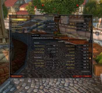

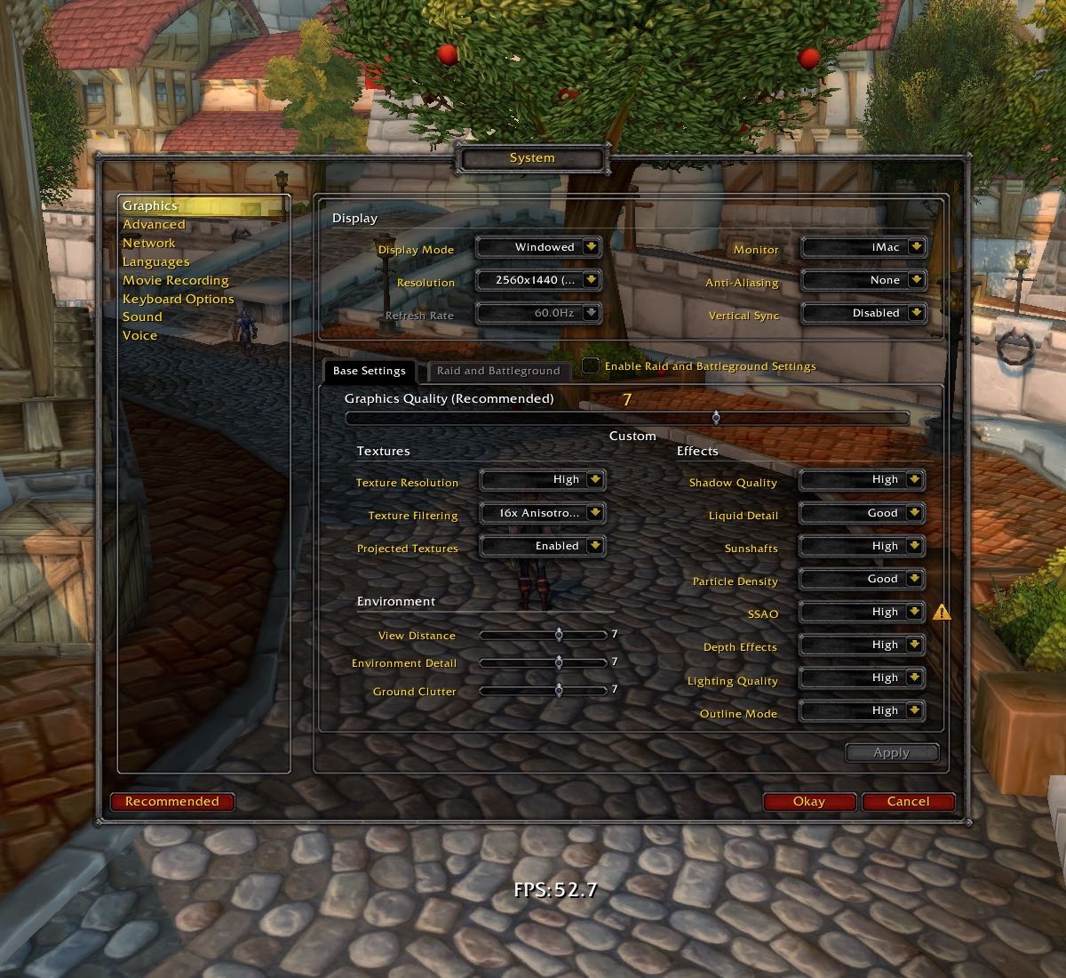

This is my setting with 15" 2015 MBP in sig
Sunshafted, SSAO etc enabled just fine. SSAO Ultra is reserved for Nvidia hence the triangle.
