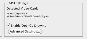

I believe OpenGL might work with the existing card in Photoshop, at least it allows me to check the box in preferences (see img). In looking at the linked functions in PS that use the GPU, though (in one of the posts above), I don't use most of those features on a regular basis. I think I'll just start looking on ebay to see if a fantastic card comes along at a good price and only upgrade if I happen to see a really good deal.
^^^I'd recommend 5770. Anything above would be an overkill for PS-only usage. 1GB framebuffer, quite good in OpenGL and OpenCL, low power demands, quite cheap. That one form Newegg is flashable. Avoid ones with single DVI and these made by Asus.

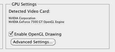

Yeah, I think SSD makes the biggest noticeable difference of any upgrade, at least in normal usage; so that was a good choice. I've yet to put an SSD in my Mac Pro yet, but I will this year! I'm waiting for prices to 512GB SSDs to come down, while enjoying the SSD in my rMBP in the meantime.
I think I may be wrong about OpenGL being completely absent for the 7300GT -- it may just be specific OpenGL extensions that were missing in the OS X drivers (but not in the Windows drivers). Pretty sure OpenCL is absent, though.
