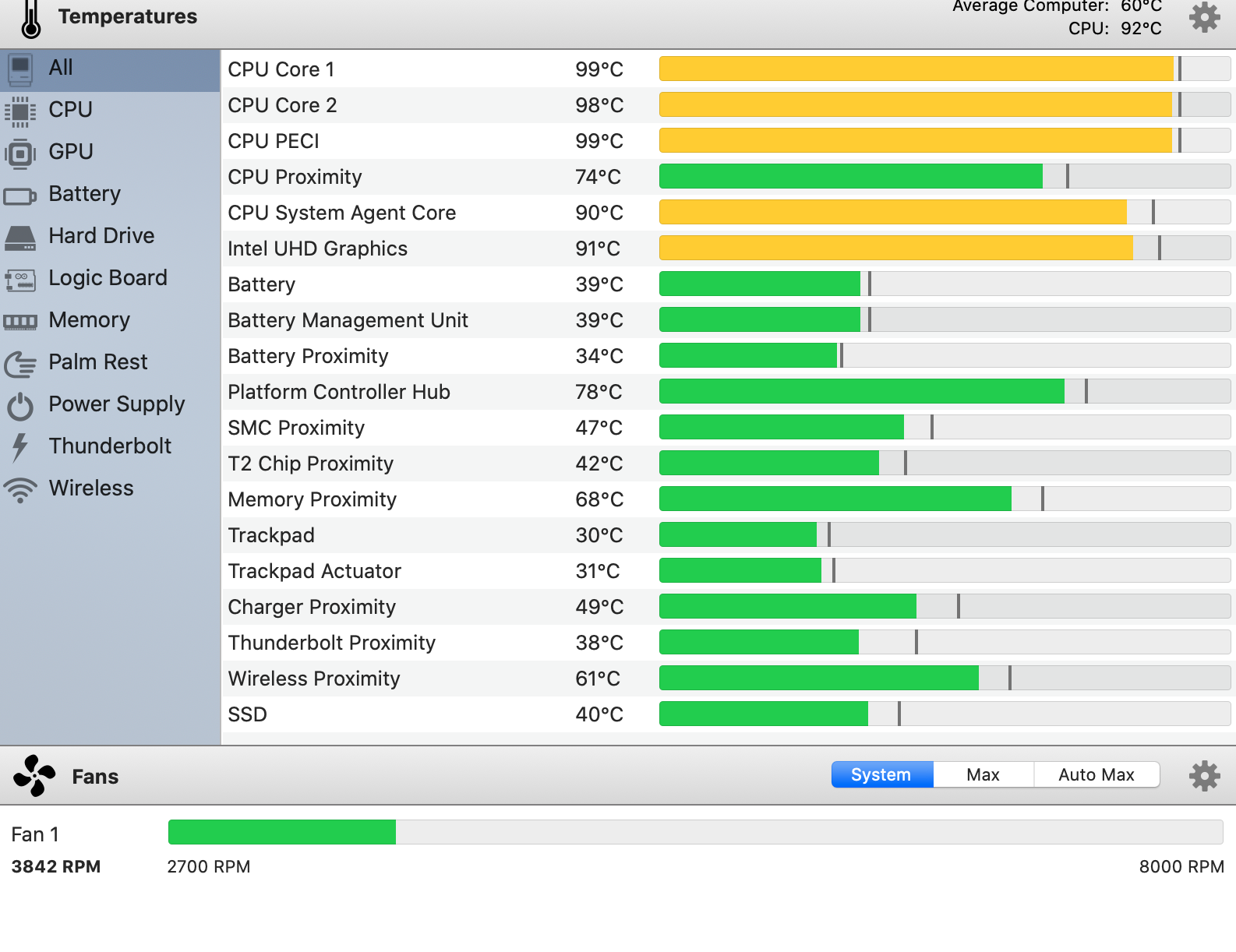

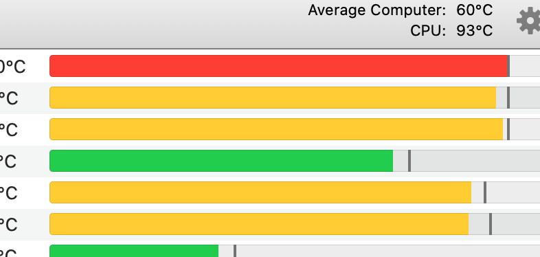

I received a refurb 1.2 GHz i7 with 16GB RAM and 1TB drive 2020 MacBook Air the other day. The fans were blaring and it became quite toasty when migrating. I’m coming from a loaded late 2013 15 inch Retina MacBook Pro 2.6GHz Quad-core i7, and this little Air seems to run quite warm in comparison. Not a big issue, but I was thinking about returning it and then I started reading some of these temperature threads.

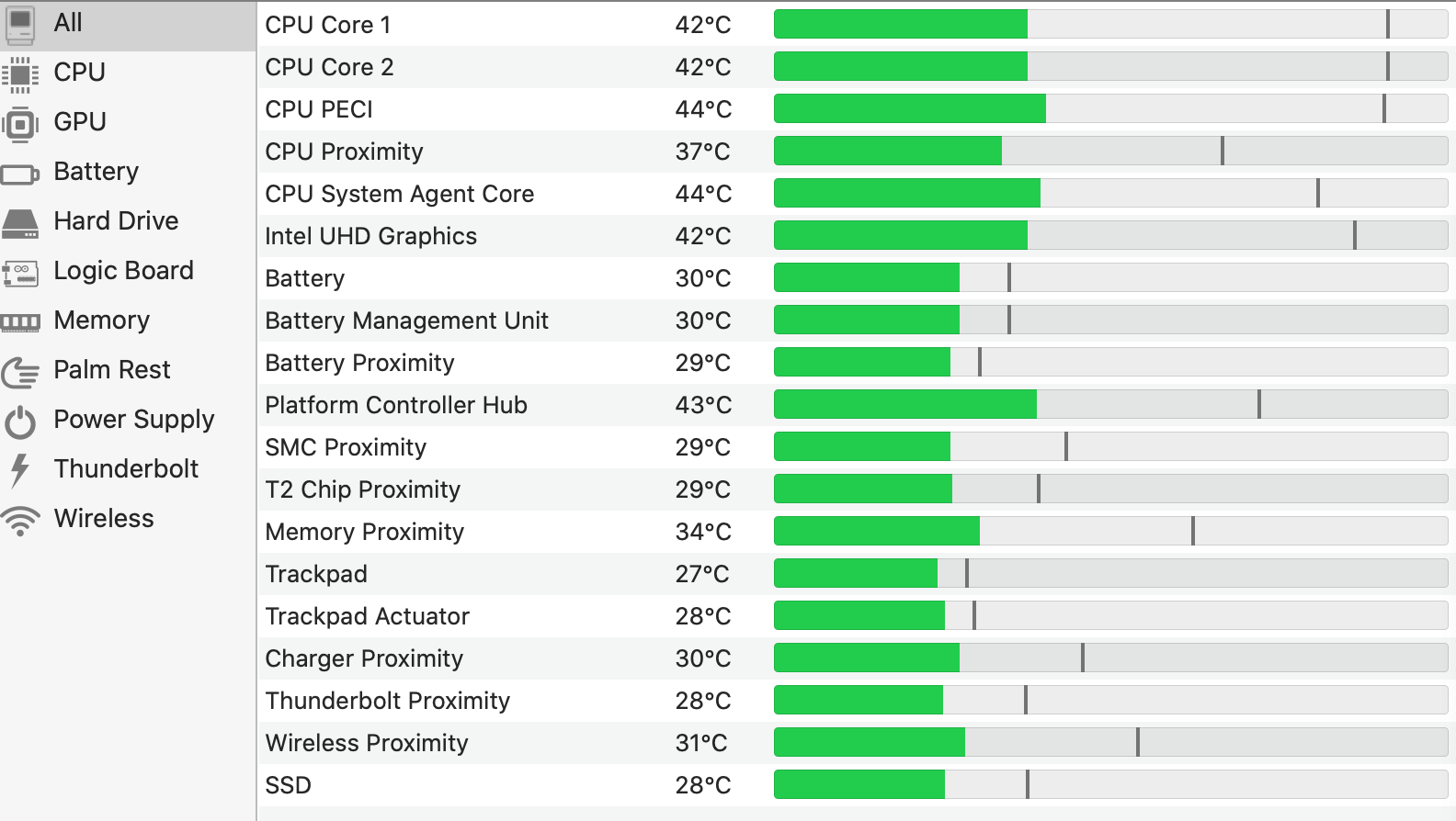

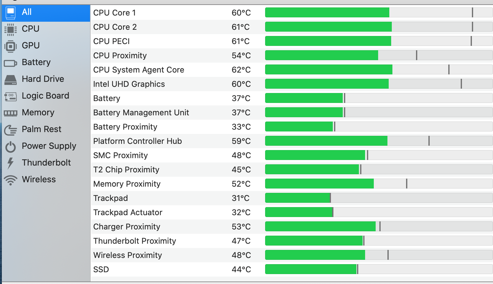

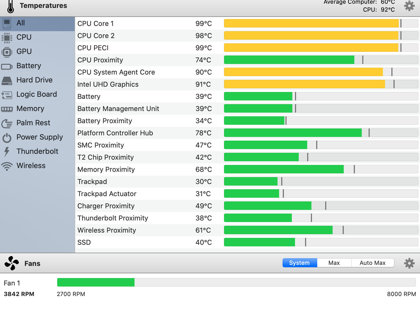

I installed TG pro. On battery power, it seems to run less than 50 degree C idling and light word processing, 60 degrees surfing the web or watching QT HD video, and will quickly reach 100 degrees when downloading files from the web, or watching security camera video via Safari. It quickly returns to 60 or so after the download completes. Plugged in, the case feels much warmer but the temperature of the CPUs doesn’t seem to change much. Fans don’t seem spin at idle, sometimes 2700rpm, 3000 when pushed a little, I see 4500 rpm after extended (10 second) downloads. Reported temp stays near or at 100, but fans will continue to ramp up until the download is complete. I’m seeing little energy or CPU stress in activity monitor, however. When sharing a FCPx movie, activity monitor shows pegged energy and CPU %, but it doesn’t seem to warm up that much during 10 seconds exports.
Is this just the way it is? Or should I spend more time investigate before deciding to return or keep? I would rather live with it if its running as expected, or return it, than opening it up.
Here’s some screen shots, idle, working a little, download, in the red.
1 Idle.png2 Working a little.png3 Downloading.png4 In the Red Downloading.png
It is the way it is and its totally normal for MacBook 2020 i7. If you are one with the fan noise like I am, you can use the Automax feature in TG Pro and set the fan for any temperature above 70 deg Celsius . That way for me, my temperature always remain below 70 degree all the time. Even watching YouTube on Safari will not go beyond 70-80.
