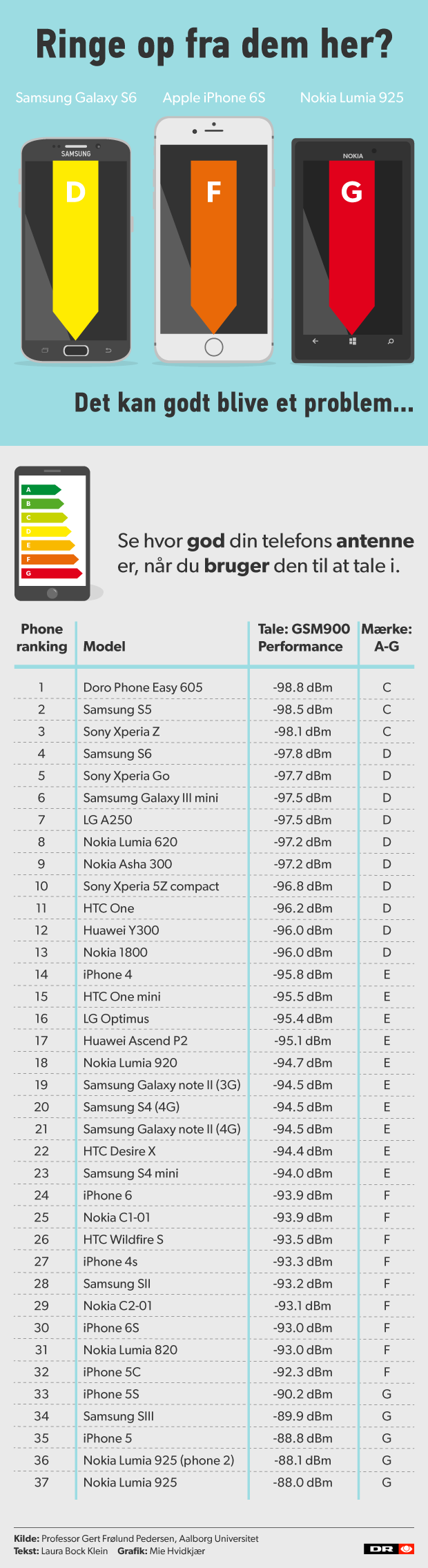

A professor tested antenna's (not including design flaws) in 37 phones for making phone calls (GSM900 band, best band for phone coverage in my country). The test was done using the international standard for testing antenna's.

I would like to k ow the "real world" difference between -98 dBM and -93 dBm.
Well it could be big, since 3 dBM difference means double.
I don't understand that table, since to my understanding closer to zero dBM value is better? For example if you put iPhone to field test mode it shows you dBM instead of dots...
Wasn't the antenna one of the hardware improvements that Apple made from the 4 to the 4S? That would support that the lower dBM is better.
"The numbers don’t follow a scale that makes much sense to normal people, but the lower the number (in other words, the more negative) the worse the signal, and the higher the number (less negative) the better.
  • Anything above -80 is good, and would be considered full bars
  • Anything below -110 is bad, and would be considered few bars
For example, a signal number of -105 is considerably worse than a signal of -70. You’ll generally find that anything approaching -105 or lower is fairly bad reception, while anything above -80 is usually good, and if you tap the number signal it’s usually shown as full bars. The full range of the signal numbers extends from -40 to -120, with -130 being a nearly impossible number to see because it means no reception, and -40 would be about the strength you’d get being right alongside a cell tower. Technically, the number goes all the way to -140, but you will almost never see that because it basically means there is no signal to speak of, and most users will see -120 or -130 before it switches over to the “No Service” indicator instead."
http://osxdaily.com/2012/08/20/field-test-mode-iphone-signal-strength-numbers/

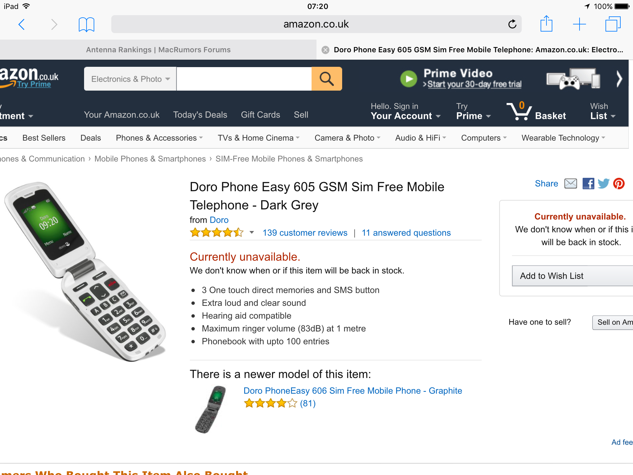

And now Doro is sold out because people read chart wrong way... 😀

Are you sure? Isn't iPhone 5 second best in this test?
yeah, it doesn't make sense. The lower the dbm, the worse the signal.
In my own numerous experiments, my iphone 5s (yes, I still keep it) always has a lower dbm than my iphone 6s's
Right, that's why the chart doesn't make sense.
A phone with a -88 dBm is receiving a better signal than one displaying a -98.88 dBm.
