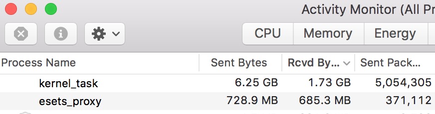

Hey guys.. I just noticed Nod32, the esets_proxy process consumes really large amounts of bandwidth. Right now it's showing 700+mb, this afternoon is was well over 2gb so I restarted. Any thoughts on what it is doing? I feel like that's really strange and should delete the program. Thanks.

I don't think there is anything wrong at all here and that process is not using bandwidth. What is happening is the AV solution sets up a proxy server that all your Internet traffic runs through so it can be scanned. So what you are seeing is your regular Internet traffic going through the proxy service and not the service itself using bandwidth. Nothing wrong at all.
Ah never thought of that!!! Thanks. I already deleted it but don't notice my system running any more quickly. May have to put it back on.
