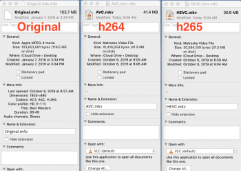

I grabbed a random video out of my photo library and ran it through Handbrake using both h264 and h265. I used all the default settings for both so its a MKV container using the avc1 and hevc compression standards.
(click image)
With no noticeable quality difference the h265 is using ~27% less storage space.

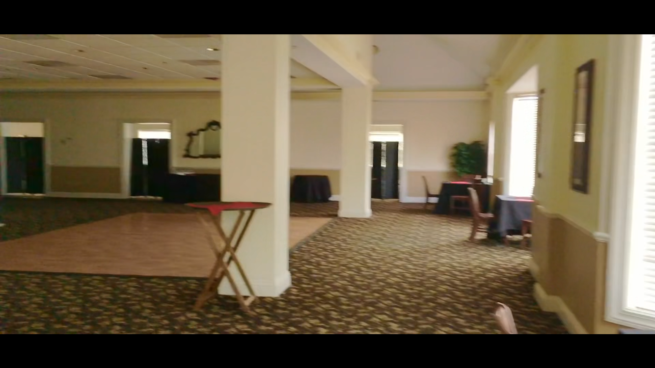

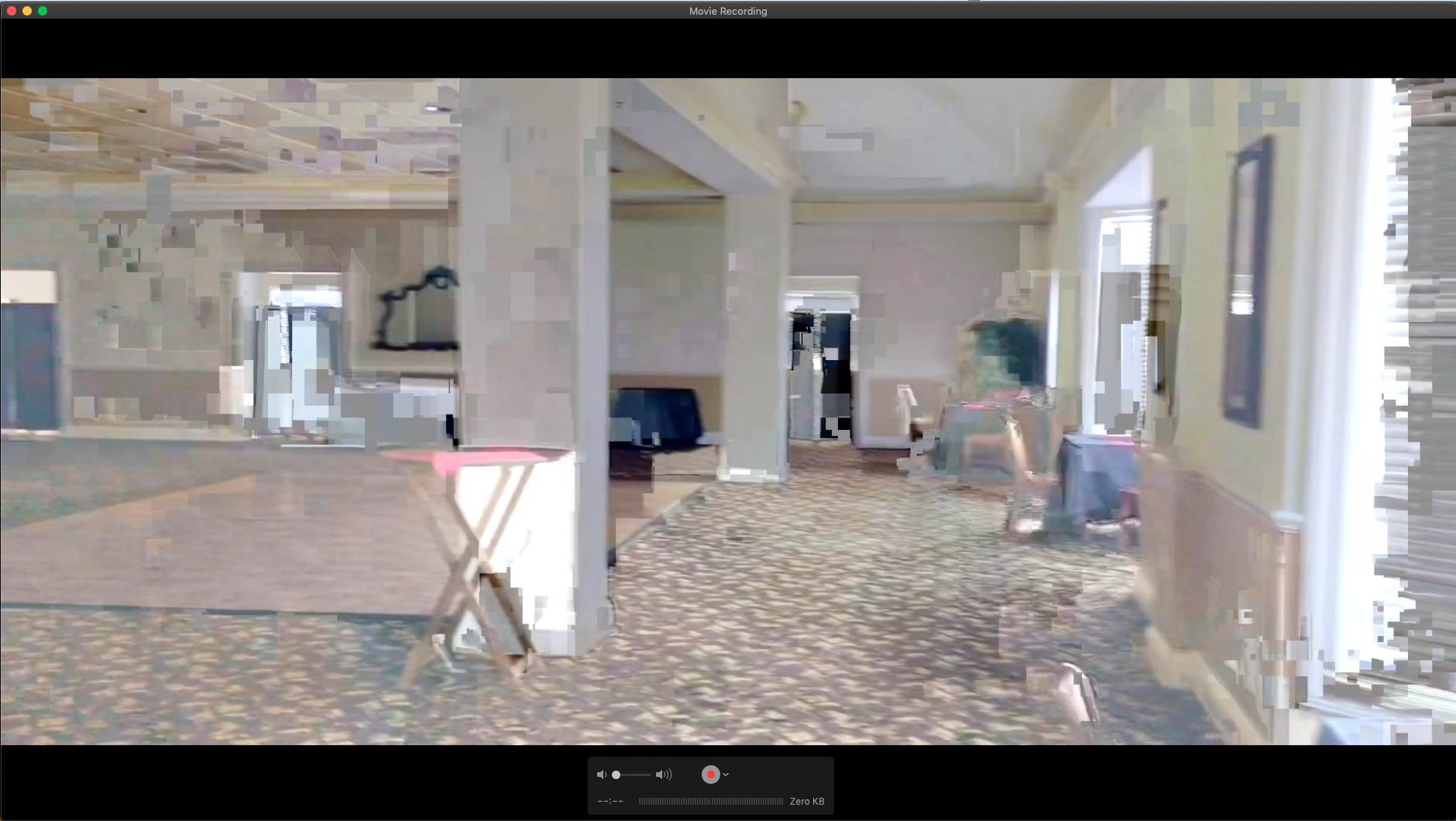

However the same file played using VLC has too complex of an encoding for the AppleTV4 to decode. This is a screenshot through quicktime of my AppleTV4 output signal attempting to
AppleTV4

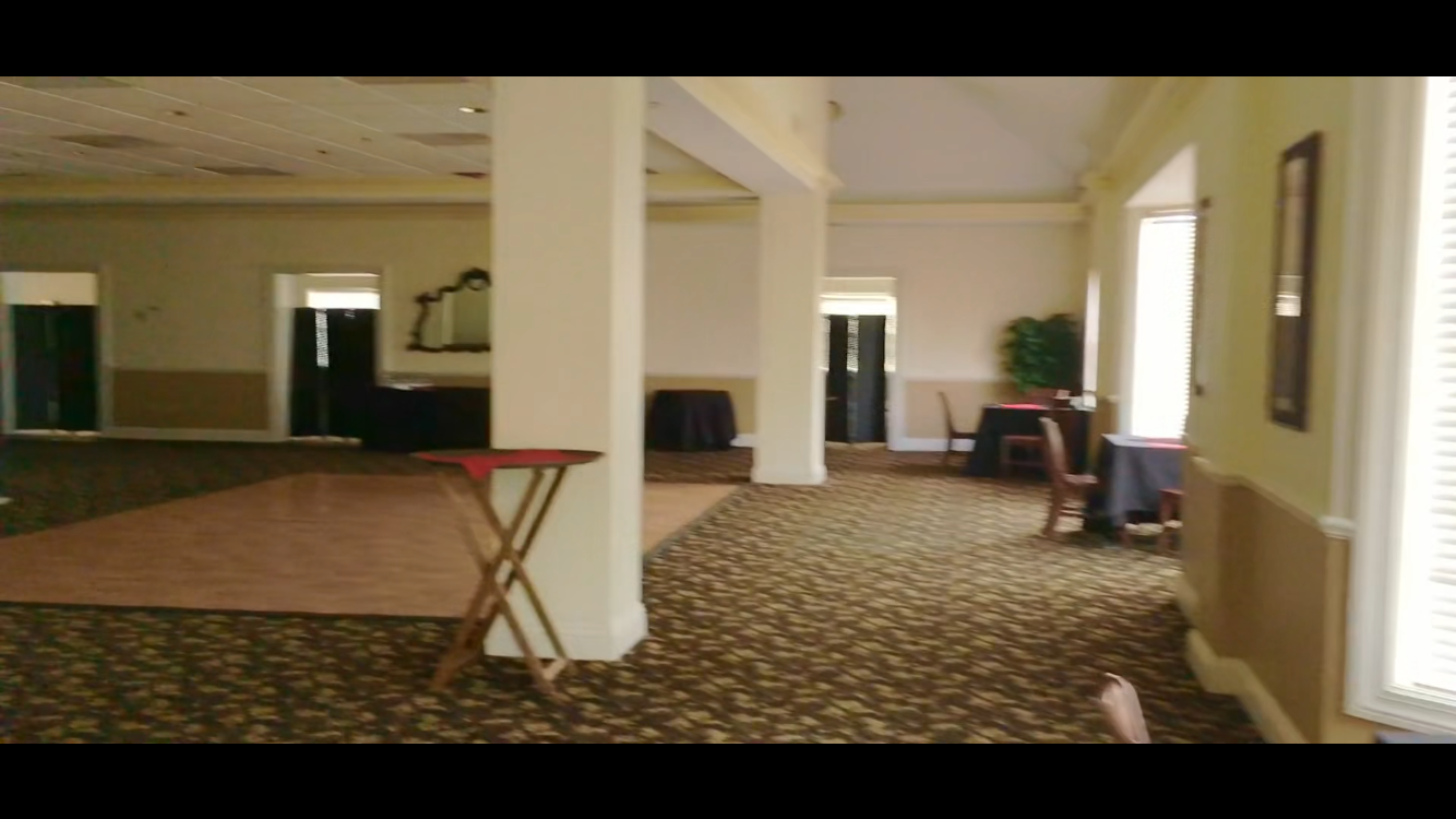

iPhone 6S (no true hardware support for HEVC) plays the HEVC video file fine in VLC.
iPhone 6S
On the AppleTV4 screen grab aside from the obvious compression blocks its playing at 5 fps with long pauses. This is especially bad since that is using the main profile, low resolution and only 30fps.
The real disadvantage about that is consistency. I'm assuming VLC isn't optimized very well for tvOS 13. Or there is some other limitation there. I question the optimization of HandBrakes h265 implementation too. Relying on 3rd app devs to optimize their apps so your videos play isn't a good situation to be in.

EDIT: The AppleTV 4 playback problem is VLC. I can see it dropping a couple frames but Infuse can playback that 1080p HEVC at a level that I would consider "watchable".

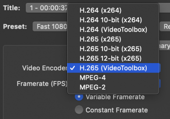

PS on your 8700-Mini, you should be able to use hardware encoding already?

Hardware HEVC encoders are worse than the x264 H.264 encoder usually. So I wouldn't reencode anything with them.
You‘re correct, the software encoding is better. In my case I was processing on a NAS which had hardware encoding. The difference in speed was massive and I couldn’t justify the small variance in results versus the huge amount of time saved. Different story if you’re encoding on a desktop with a decent CPU though.
It's also worth mentioning, that HB does not upscale (ie. 1080 -> 2160 is not possible), only downscales.
hardware encoding on the mini(videotoolbox) doesn't support 10 bit which I need. A movie encode with my settings is only 2 hours on the mini(12 on my PC) so I'm not worried about it. The T2 chip could do it but as far as I know only apples software can access that for encoding.
Don't know about T2, but the i9 inside my iMac can also do 10-bit HEVC encode in hardware. The Coffee Lake inside your Mini does as well. It's the apple VideoToolbox that does not yet take advantage of it. (Haven't upgraded to Catalina yet, btw).

Handbrake doesn't support 10bit in videotoolbox. It's noted in their docs.

I am on Catalina and I just grabbed the handbrake nightly build and there's no change to videotoolbox. Still no 10bit.
