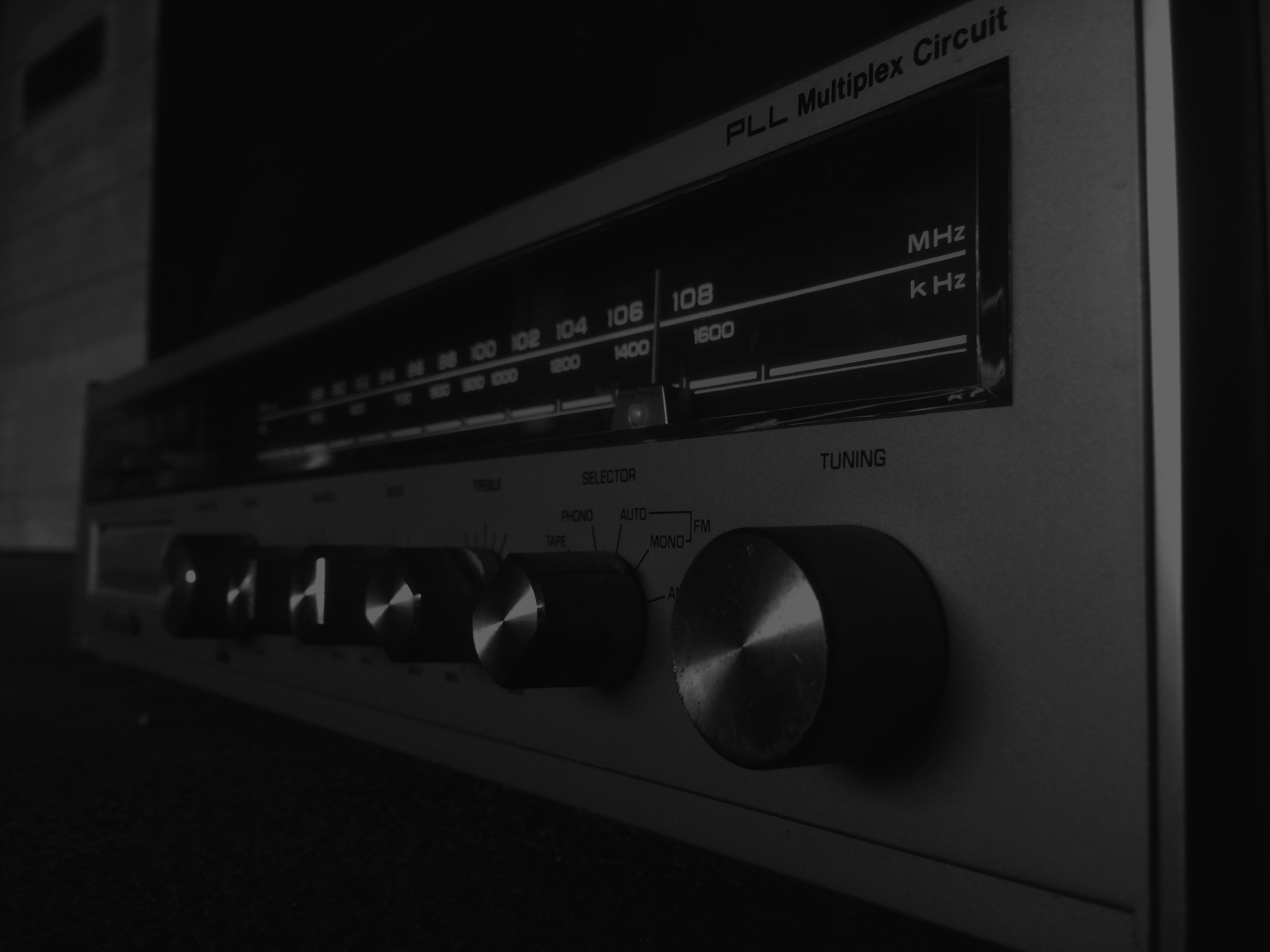

I recently got a Pioneer receiver from around the mid to late 70s and it all works perfectly except the turntable. I also got two speakers with it. The thing is, the speakers are RCA, and the only outputs are RCA. So dumb ass little me takes an alligator clamp, clamps it to the output and clamps the other end to one of my better speakers wire's. Of course, it didn't work. The RCA out sparked and now I can't get audio from that channel w/ the original speakers. The other channel works just fine, so I didn't blow the amp. I have no idea what happened, Google comes up with zero results. This receiver sounds incredible and looks incredible, I'd hate to be the one to kill it.
Can someone here give me some advice?
Nothing smells or looks blown, all wires seem to be intact. Left channel works, right channel is the broken one, but can still be sorta heard when cranking the volume all the way up.

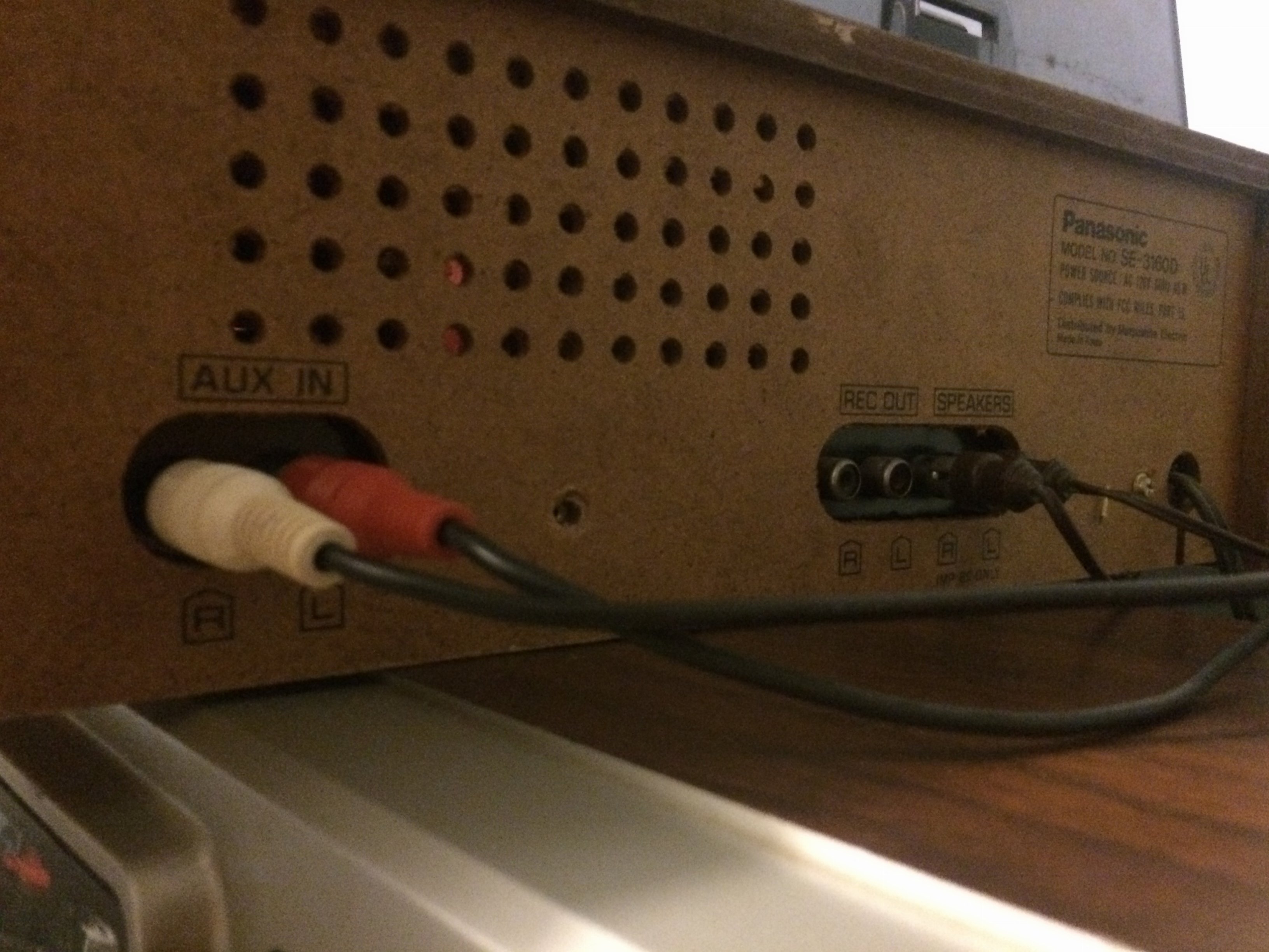

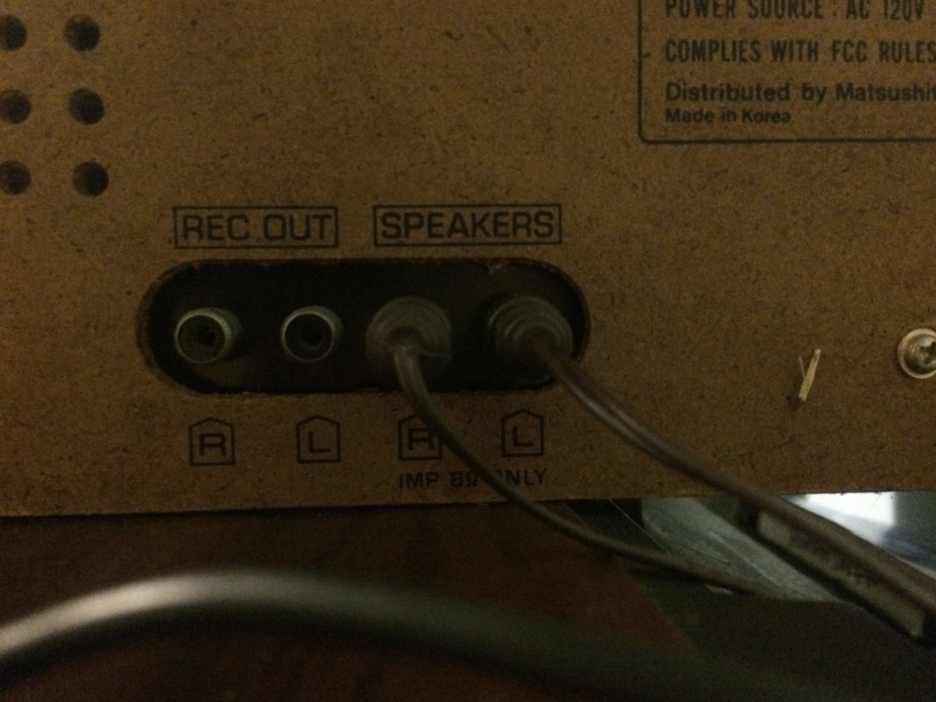

Heres what I'm working with.
Left channel is working, right one is not.
Anything else you'd need a photo of?

I see - I re-read your first post, I thought you were using the original speakers not your own. There may have been a mis-match on impedance but I've never experienced a short circuit from that. You say you can hear faint sound when the volume is up, that make's me think it can't be a blown fuse.
Does the amp have a headphone socket, does that work?
I can only think when you used the crocodile clip you made a short circuit with the right output finding no electrical resistance.
When I was young I messed around with no end of stereos, amps and speakers but nothing ever 'popped' - the audio would be dead until I got it wired correctly, I'm guessing this was perhaps close to dying anyway.
I'd open it up and firstly look for an internal fuse, then any obvious burnt out components.
On the bright side you haven't spent anything 🙂
If all else fails, splice the left speaker into the right one's cable and run the output as mono (if it can - will work either way) - you'll still have a good looking retro piece that makes some noise.
