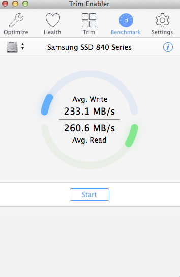

I have only now discovered the joys of TRIMing my SSD boot drive and am seeing results that I used to see when I bought my Samsung 840 new 5 years ago. My main drive is currently occupying where the optical drive used to be and I understand that the Sata connections might be limited there. Given the age and technology in my older drive, would I see any benefits from a PCIe adapter?

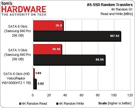

As you can see, there is virtually no improvement (in boot time) for a 840 Evo by moving from SATA II to SATA III connection. Even go for PCIe 2.0 won't make any difference.
Boot time is not affected by the sequential read speed, but the random read speed.
This chart explain a bit more. As you can see, the 4K random read speed (~35MB/s) on a SSD is nothing close to the SATA II limit (~250MB/s), but it's 30x faster than the traditional HDD. This is the real reason why the SSD can speed up the boot time. If sequential speed can affect the boot time, then a 10x HDD RAID 0 array can boot 5x faster than your current setup. However, it won't, because the 4K random read speed still slow for a 10x HDD RAID 0 array. Also, no matter the SSD is connected to a SATA II or SATA III port, the 4K random read speed still roughly 35MB/s, no noticeable improvement.
