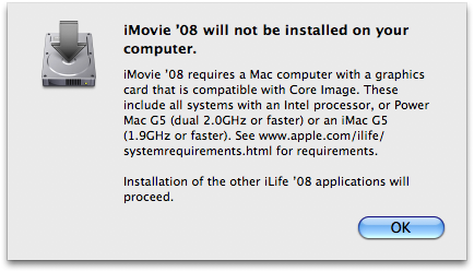

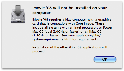

Thanks. I'll have to install iMovie '06 since '08 is not compatible.

Edit: Scratch that. '08 is the earliest iLife that I have. I guess I sold the '06 version a while back.

Also note that Apple made iMovie HD '06 available for free to owners of iMovie '08. Partly due to compatibility problems (older machines that couldn't run '08,) partly due to the outcry over how completely different '08 was from '06.
Sadly, Apple appears to have removed iMovie '06 from their download site, so you'll have to find it elsewhere. (Google can help with this - which I don't think is a big deal since Apple offered it for free directly in the past.)
