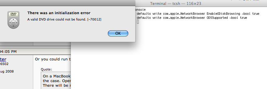

Nope, doesn't work. Same error I've been getting:

Did you reboot? It doesn't look like it because the terminal window is still open.
Yepp. Same thing. Redid without trying before boot, same result. I think I'm going in for the Hex editor now. One of the beauties of an optibay is two drives with two or more OS's to screw up.😱

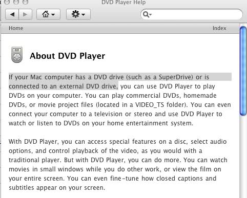

I just looked at the help file for the dvd player on SL. I wonder why it says this? 😕

The problem with DVD Player & Apples blurb is you need an onboard DVD player to use DVD Player w. an ext. DVD player - unless you're using an Air. So they aren't exactly lying but they are massaging the truth to happy ending.... the key words are "has a DVD drive...."

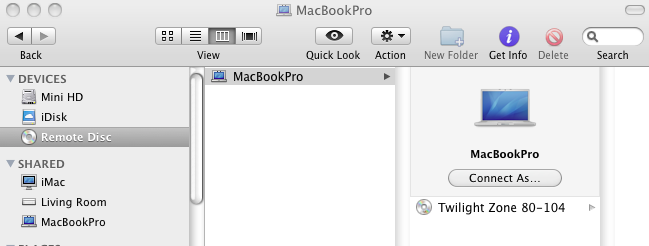

I am now watching Larry and as expected, screen shots won't work!
