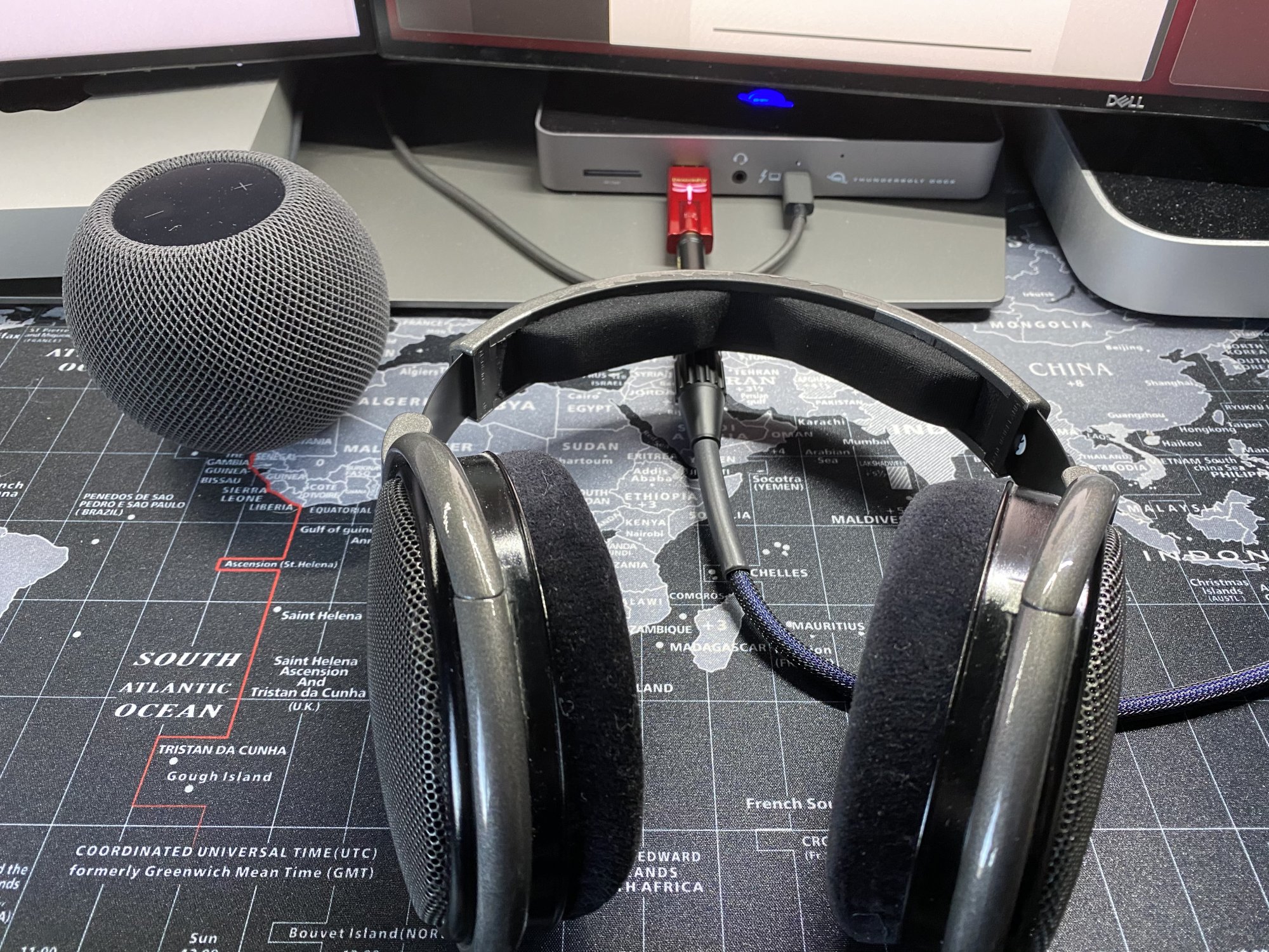

I thought people might get a grin out of my use of the dock. AudioQuest DragonFly Red DAC/AMP, BlueDragon (Moon Audio) cable, Sennheiser HD-650! Still wish the USB-C to MacMini was in the back!
Maybe I'll slip the Sennheisers on the HomePodMini and give it an audiophile treat 😛
Happy Holidays everyone!
