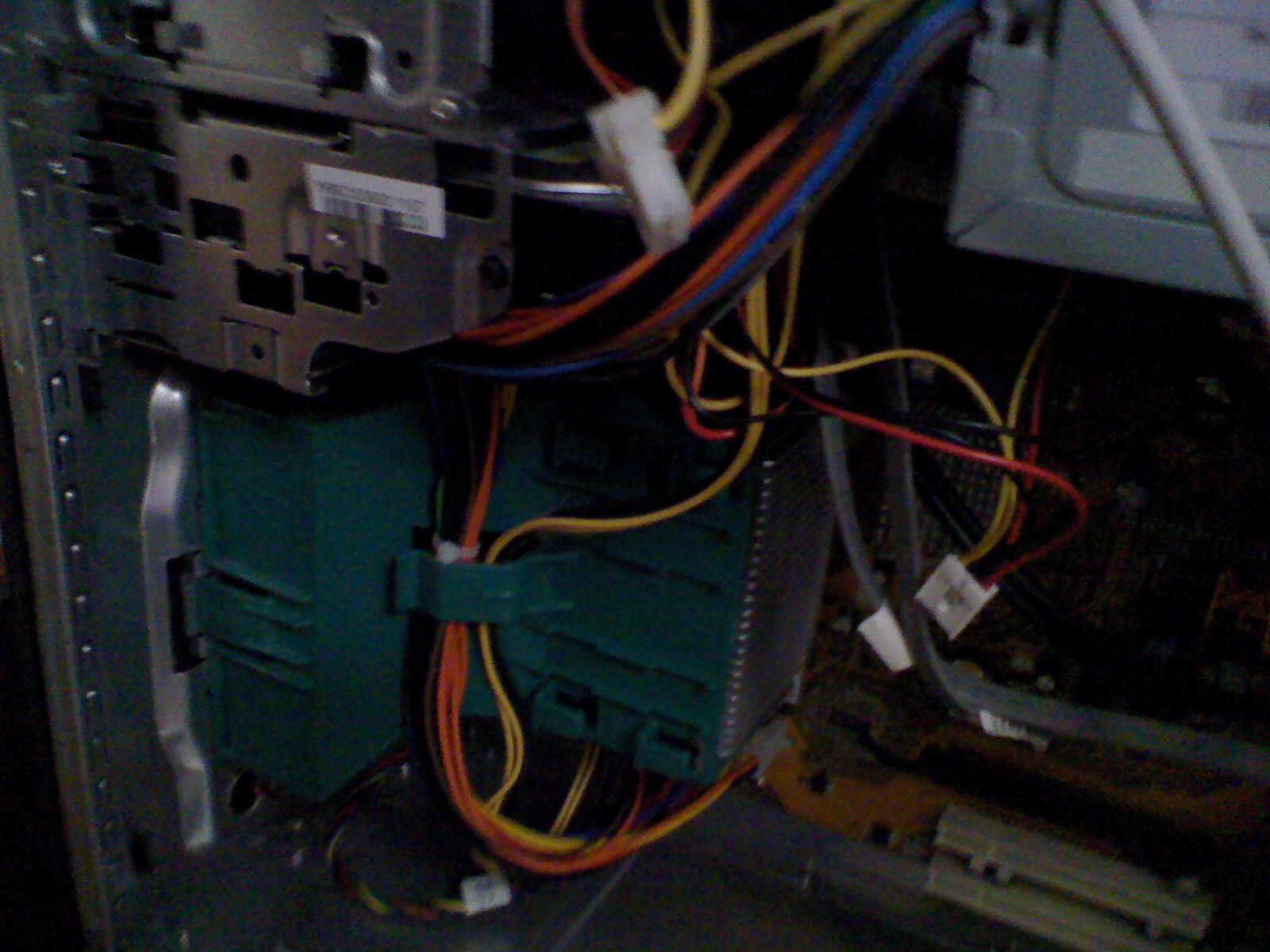

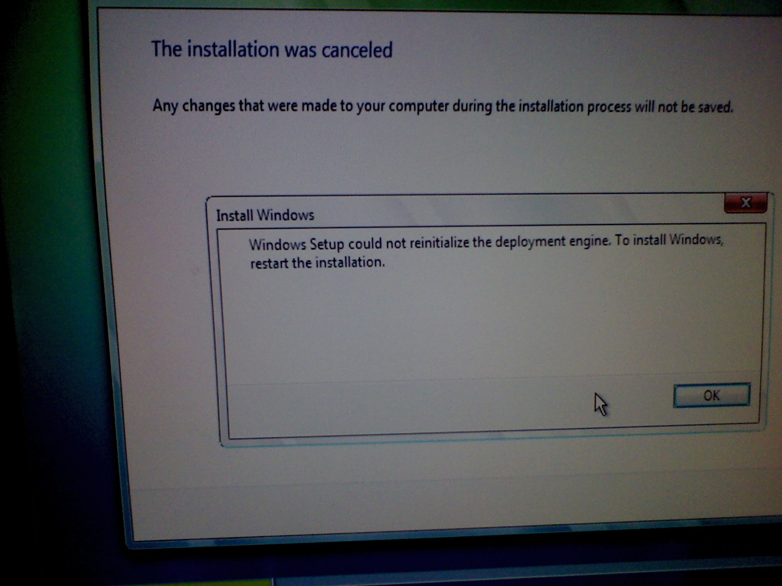

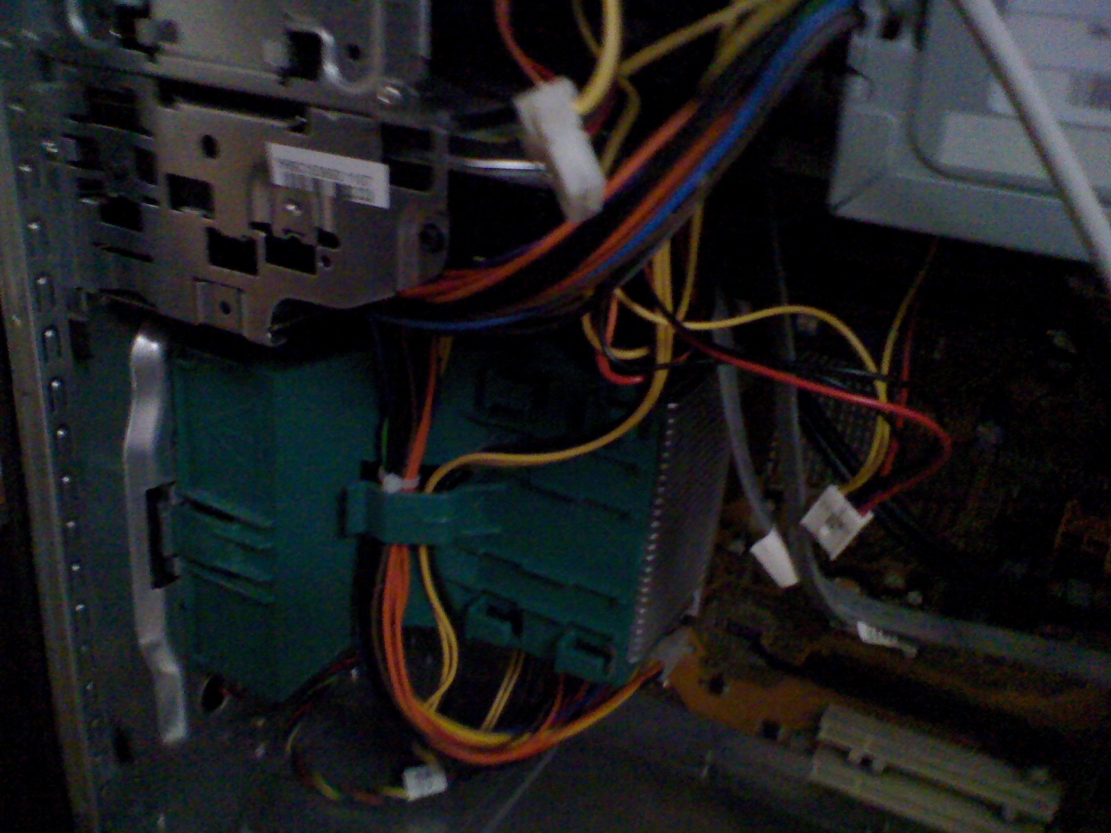

My friends PC is a bit screwed, we are fairly sure its a hardware prob, the computer cant seem to read the drive and we have tried reformatting it but its not working, neither is reinstalling Vista.
All anti-Microsoft comments aside, can anyone help?

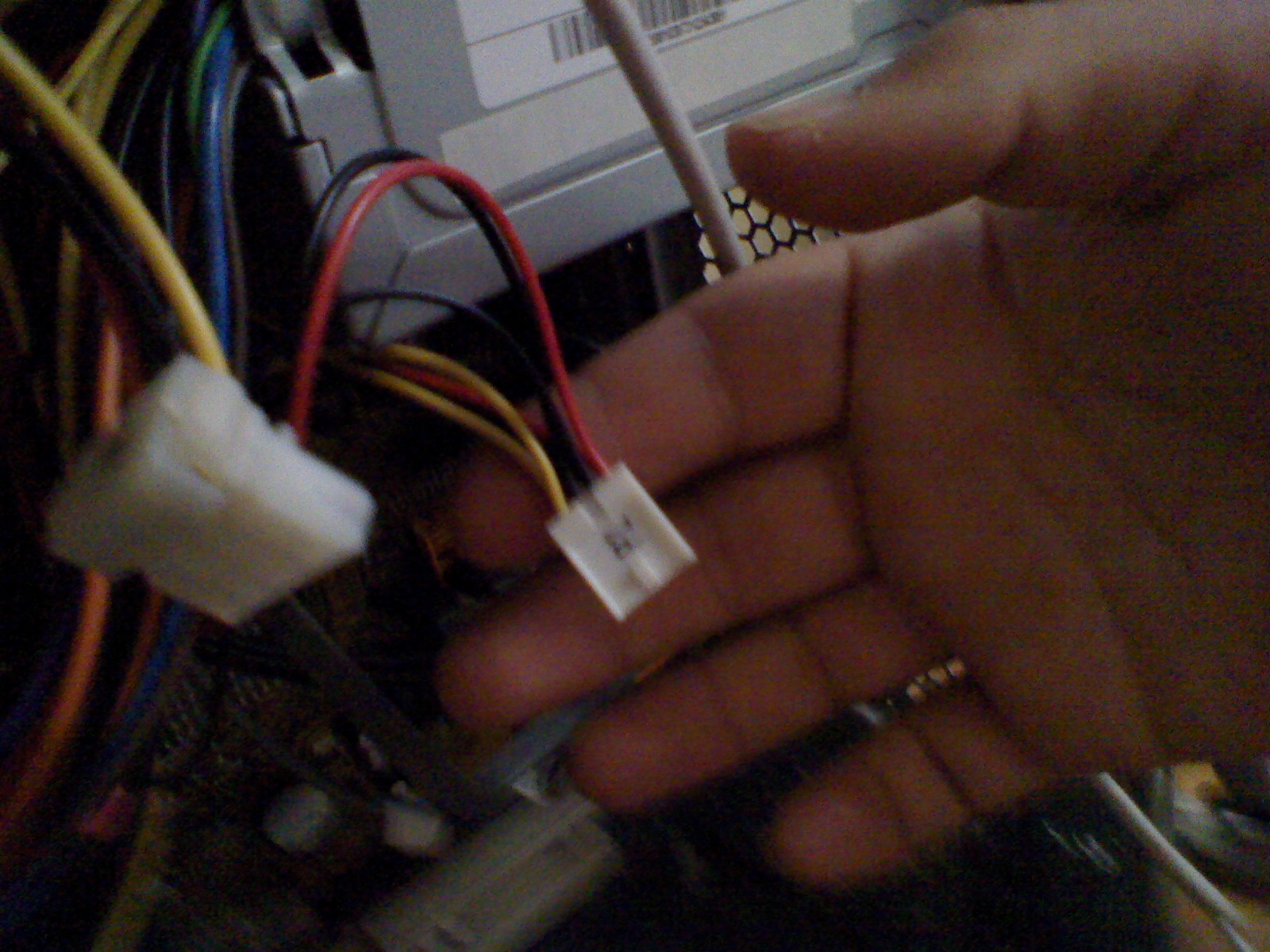

Attached are pictures of the inside of the computer, thing that are unplugged from inside the computer that I have no idea where they are meant to go and the error we got when trying to install Vista.

The unplugged things are just extra power connectors (for additional drives etc). They are normal in a PC: don't worry about them...

drive not reading is the problem. now the question is why is it not reading the drive? i can see the sata cable and power connector going to the hard drive in the pictures, you could try re-seating the cables (with the power off). that is gently pull off the sata cable, and then push it back on, and same with the power connector. the extra bits are just unused power connectors, no need to worry. as above, you do need to get into bios and see if the drive is showing up. for fujitsu laptops, it mashing the f2 button at the first screen, don't know about desktops, but that, or f10, or delete... something should work. if reseating doesn't work, you could also try replacing the hard drive sata cable as a quick/cheap check to make sure the drive is the problem.
the video gave me motion sickness! but did notice it starts by showing the boot from lan screen. that is, the computer can't find a drive, or disc, so it's trying to boot off the network as a last resort. and the next try with the disc in, it boots straight away, so bet the hard drive is dead.
if the computer is under warranty, request a new hard drive. if not, find a decent sata drive, pop it in, and install windows as the rest seems to be working fine. best of luck.

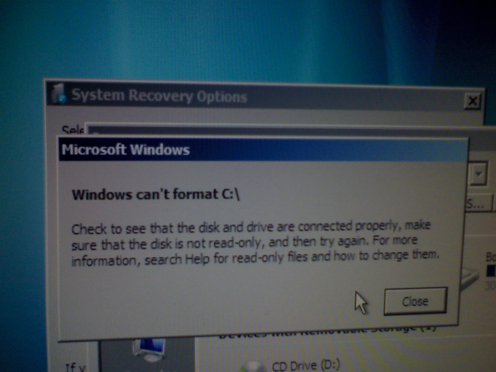

Right disconnecting it and reconnecting wont work and I tried reformatting C and got this, meaning there is definatly something wrong with the drive or the connection to it, also when it boots now with a disk in it hangs on "Press any key to boot from CD/DVD"

To add to the other comments already made.
Double check all connectors, by re-seating them. Believe it or not, they can come loose during normal operation due to the vibrations of the PC. Additionally, sometimes connections oxidize a bit so they won't work reliably. By re-seating the connectors many times you can improve the connection to were it will work reliably.
Regarding checking out the hard drive, if it is spinning, IMHO, there is no better software than SpinRite for any platform (Windows, Mac or Linux formatted) when it comes to drive recovery and maintenance. Well worth the fee. The only negative is that you need a PC to run it.
Of course these days, you can pick up a a large HD for under $100 so it might not be worth it to try and recover the HD and just get a new one.
