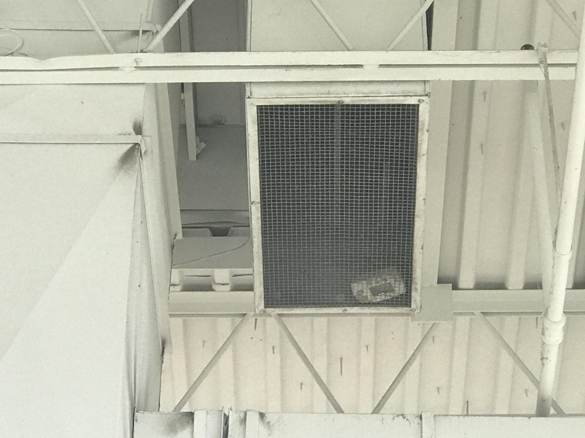

Saw this on Reddit and immediately thought of your post. 😛😀
