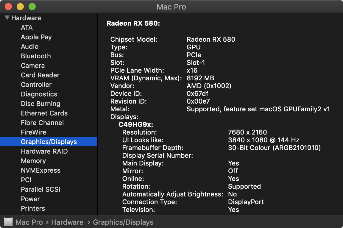

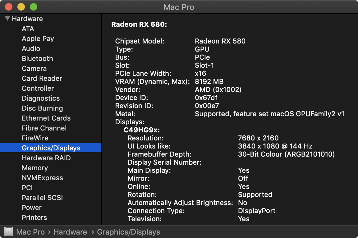

I am running the same monitor with RX580 (on my Mac Pro 5,1). It's OK to run at 144Hz, even with 10bit and HiDPI (for better screen capture and text AA) still can do 144Hz. So, not macOS issue.
For testing purpose, I ran this monitor with HD7950 and R9 380. From memory, both can't do 144Hz but only 120Hz (non HiDPI). Since even the D700 is just belongs to the HD7xxx family, and older than the R9 380. So, I believe your GPU can't do 144Hz at that resolution. In fact, as per Thunderbolt 2 spec, it's only DP 1.2.

well guess I have to do with 120 hz then ...but how in the hell did you get 7680x2160 resolution on the same monitor
I don't have this option. ...newer Gpu options I presume ? or does this have to to with this ..Hidpi thing that is non existent on my Mac. ...and this 10bit option ...were do I find this option ... and one last thing ..1,2 or 1,2+ ...settings on the monitor.??

h9826790 has a 5,1 cMP (2009 -2012) which enables him to use standard PCIe desktop GPUs which support that option (as in his RX 580). With your 6,1 nMP (the trashcan-late 2013+) you are limited to whichever GPU came installed with it (D300/500/700) and cannot upgrade to run the higher resolution/refresh rate.
